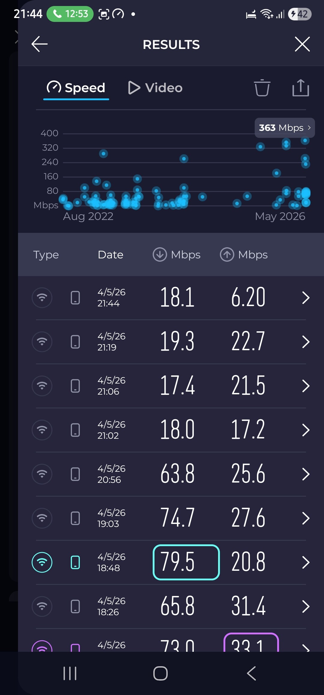

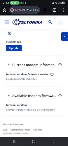

Hi Please help me,
I am experiencing slow 4G Speeds, below 20Mbps, never more than 79.5mbps.

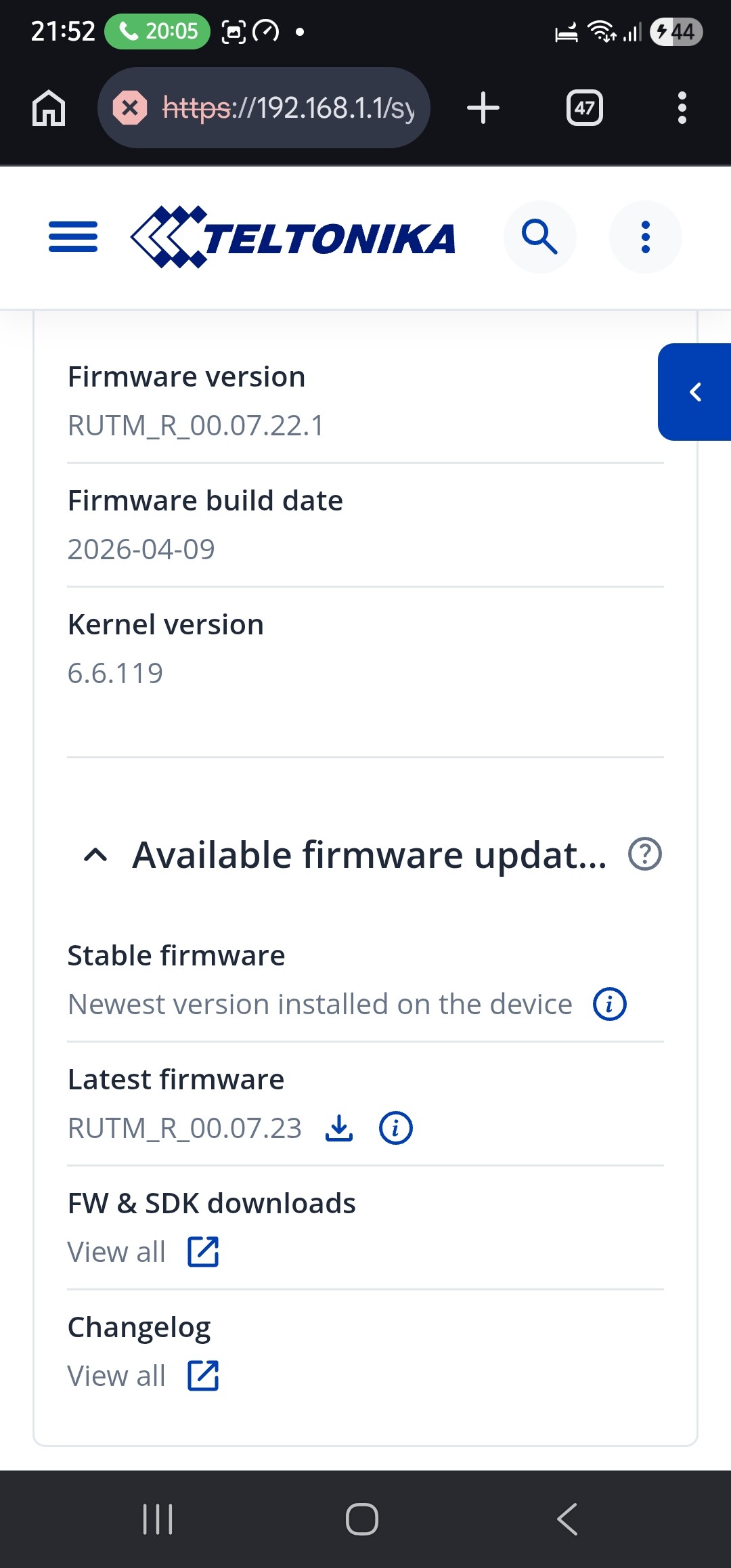

I have updated to latest stable firmware.

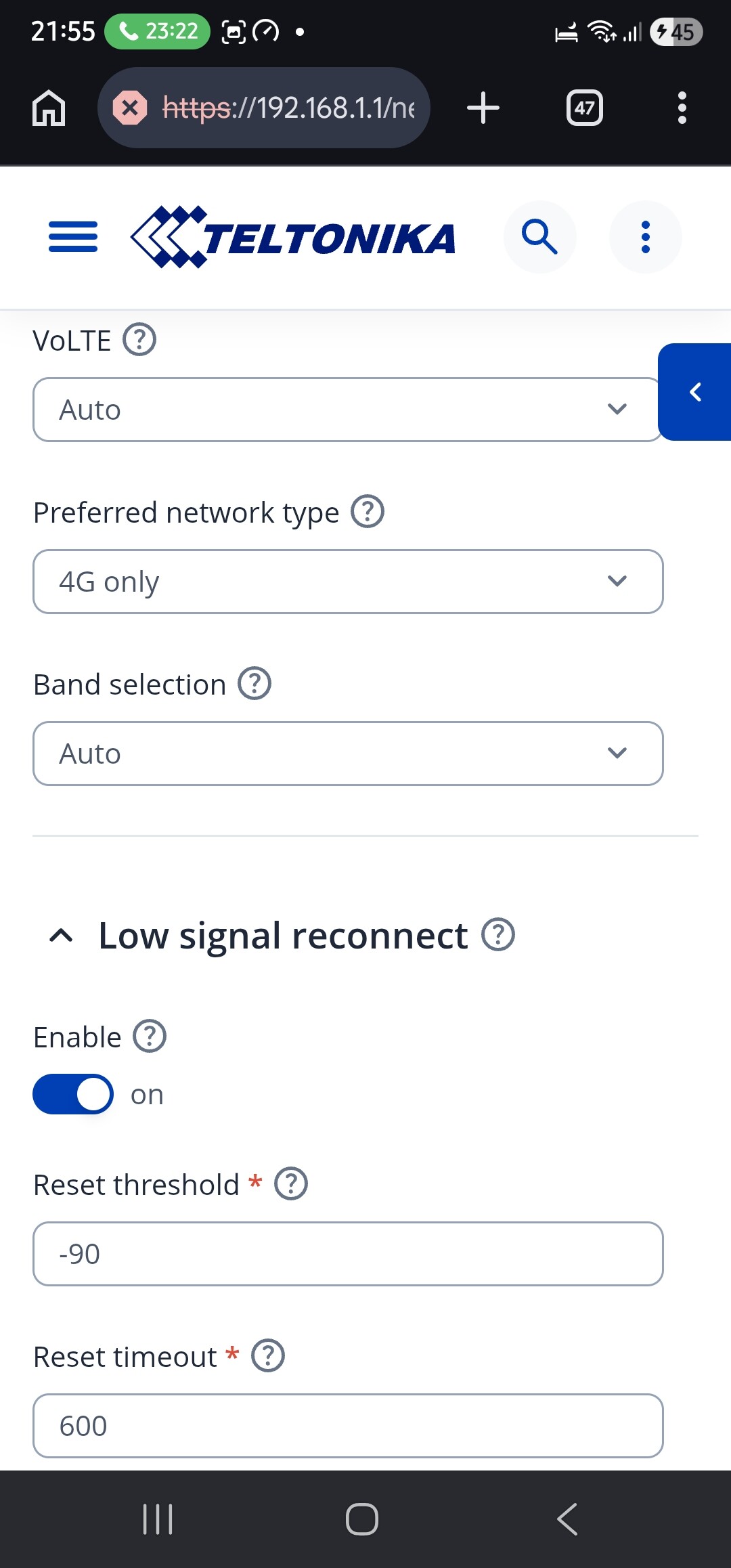

I have tried different APNs, no change.
I’m in Australia,.my prov8der is telstra.
I have tested this data sim in a 10yr old Samsung Galaxy S8 and it showed speeds of 180Mbps.
The spec sheet says that this device is capable of upto 300mbps.

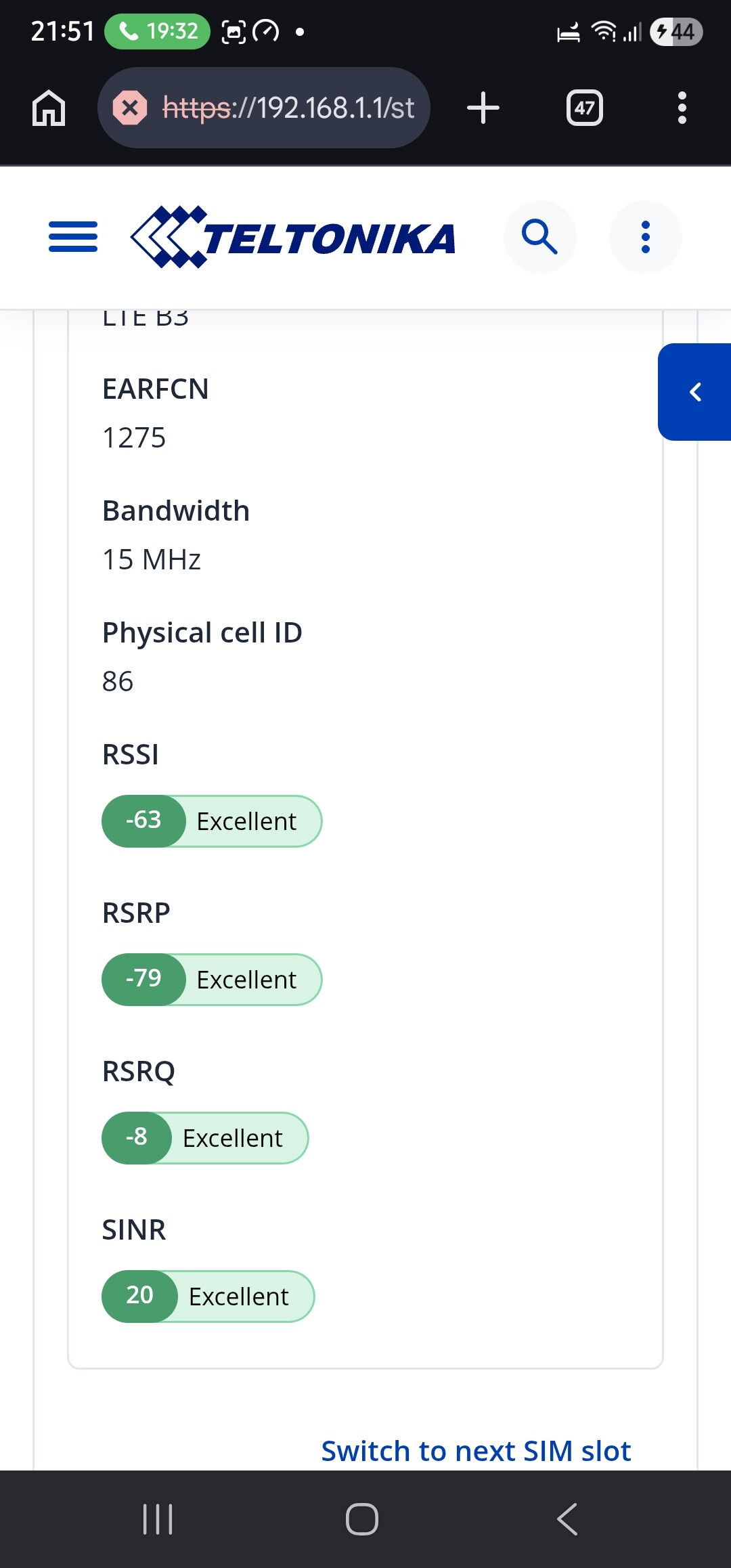

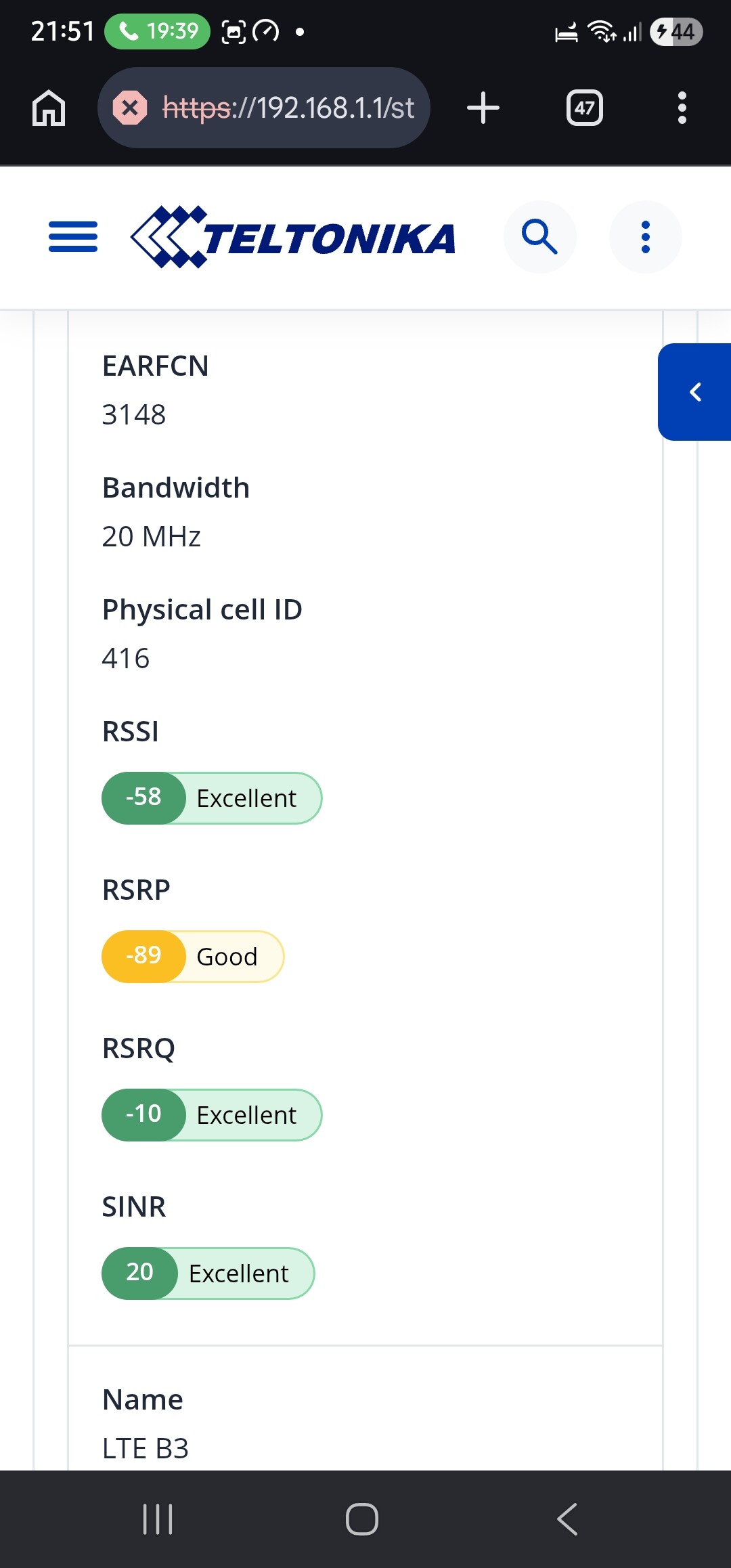

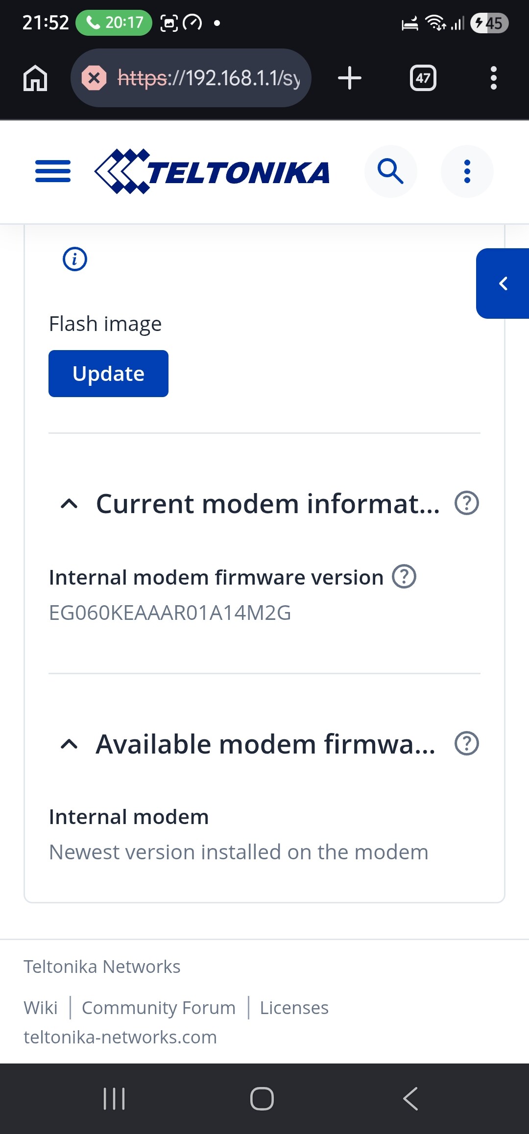

Please see screenshots below of speeds, firmware, Modem and settings.
Please help me and let me know if I can provide any further information to assist.
Thank you so much!!
Modern phones support faster LTE technologies and different modem architecture than most Teltonika Networks devices as they are made and used for different purposes. Most of the speed discrepancies are due to carrier aggregation (CA). To see how CA and other factors can affect LTE speeds, please refer to the LTE Speed Discrepancies page.
Based on the information I found, the Samsung Galaxy S8 has a LTE Cat 16 modem with support for up to 5 carrier aggregation (5CA), while the RUTM11 uses an LTE Cat 6 modem that can aggregate a maximum of two bands simultaneously.
If you haven’t tried already, you could experiment with band locking (Network → Mobile → Connection) to see how speeds or stability change on specific bands. More guidance on band locking can be found in the sources below:
