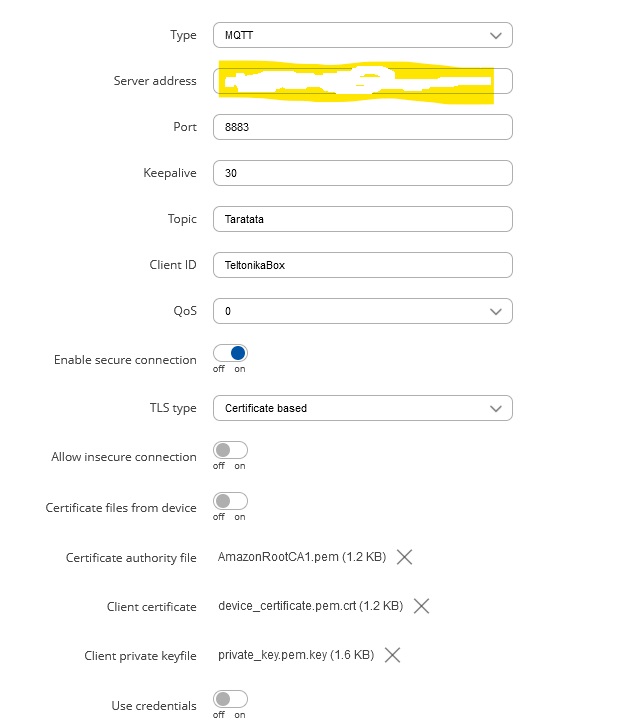

Here is the config of AWS part of TRB245… but still not working…
Hello. I followed the thing carefully but it is still blocked somewhere… Any additional advice like a way to see what happens and where it is stuck ?
You can try to check connectivity via mosquitto directly. For this, you will need to upload certificates to your RUT device first. For example, to /etc or /tmp directory. You can use SCP or SFTP (here).
