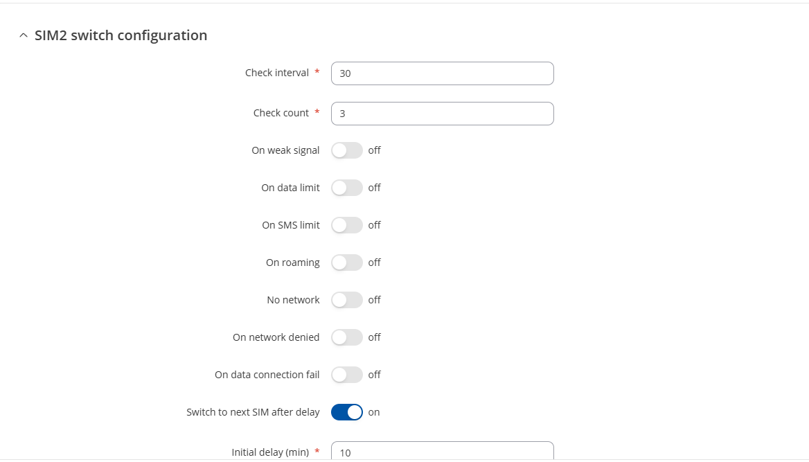

I have a problem with Teltonika RUTX09 in webUI : Network - Mobile - SIM switch. In this section there is no any values for configuring this feature…
I updated last firmware version - this action hasn’t any results.
Please, could you help me for solving this issue.
Picture of webUI in attachment.

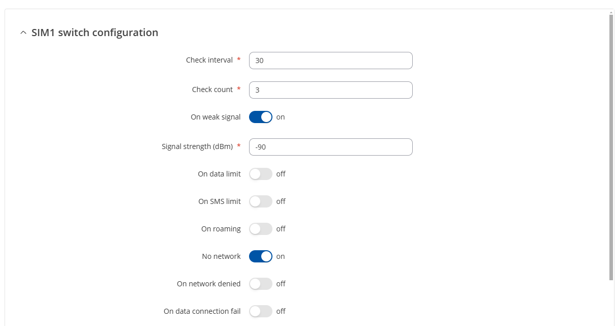

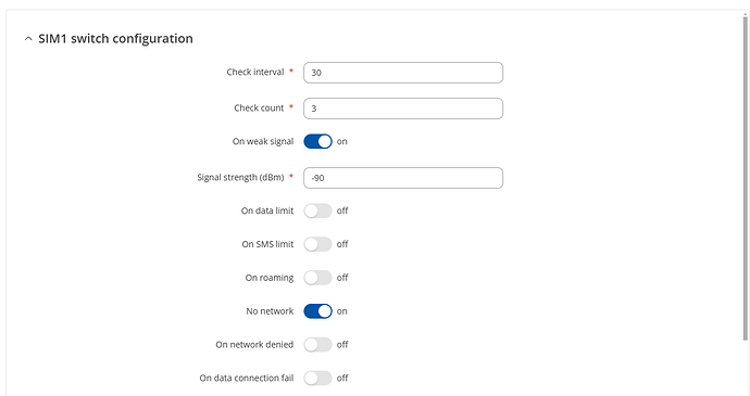

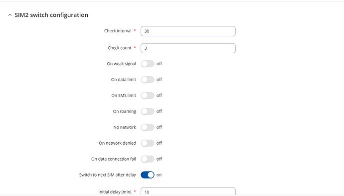

Before was 7.11.3 FW, but after upgrading FW to 7.12.3 it’s was not working. It’s was working after resetting, as a mentioned above.
I selected ‘low signal’ & ‘connection disappearing’
