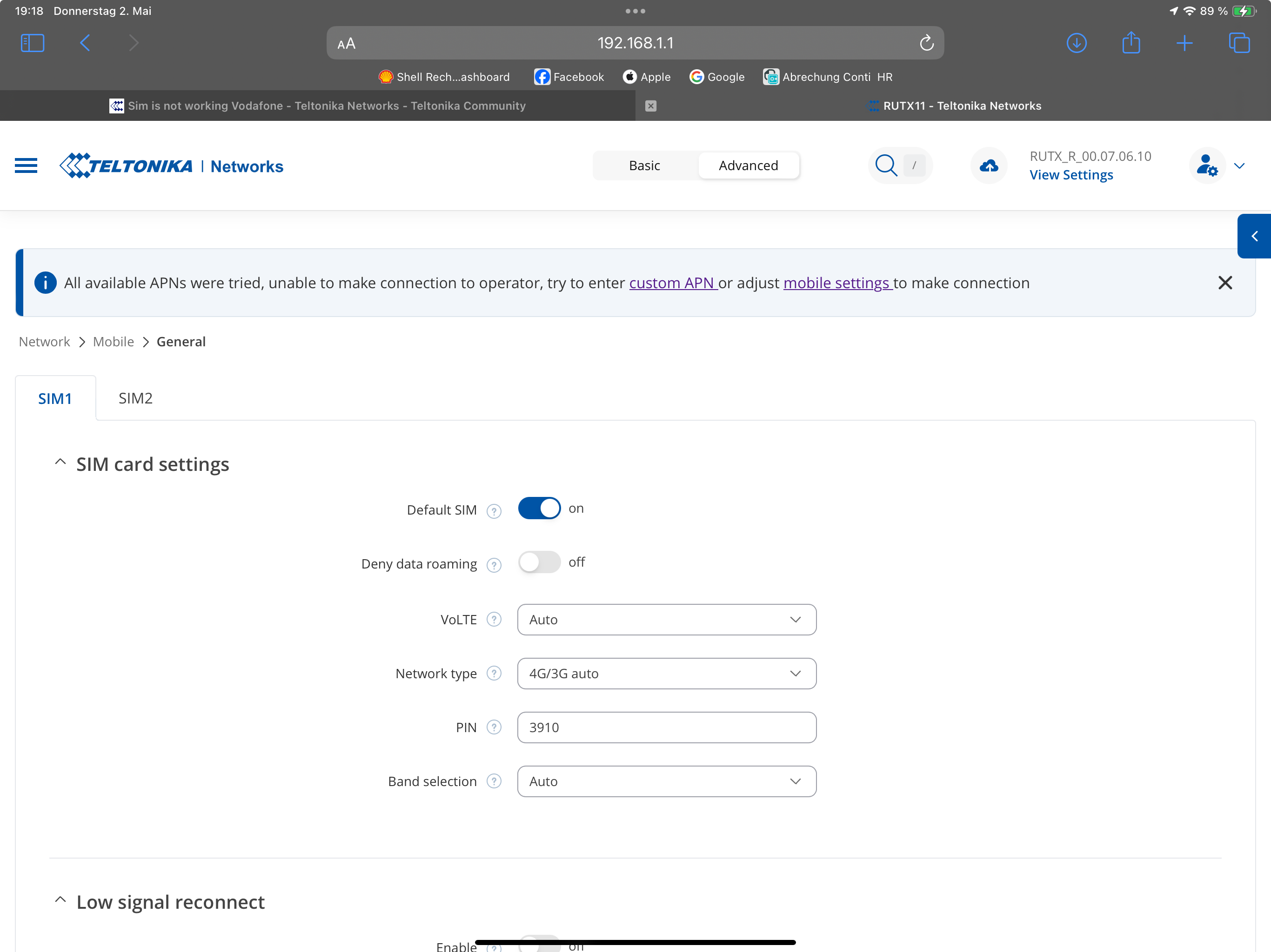

I have an RUTX11 and use a german Vodafone card. It works perfect in Germany for a long time.

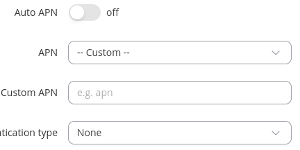

No I m in Slovenia on holiday and it didn t connect the service. I update to the latest firmware as i saw some people has a simular problem. But noithing. I see in the overview the sim is inside and signal is strong. It show no service. I set APN from Auto to custom and put web.vodafone.de in. Nothing. I change from SIM1 toi SIM 2 slot, still same. I put the card in my IPhone and it works great.
I change from IP4 to IP4/IP6 still not working. Reset to factury devaults, no change.

Hello, try to set your APN manually and leave it for longer period, lets say for a hour. Roaming sometimes takes time to connect and if you do changes in configuration modem start connection from beginning which will reset its previous attempt.

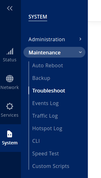

Could you paste log from System->Maintenance->Troubleshoot “System log”? there should me more info what is happening.
P.S. Cut sensitive info that you do not want to show here.
