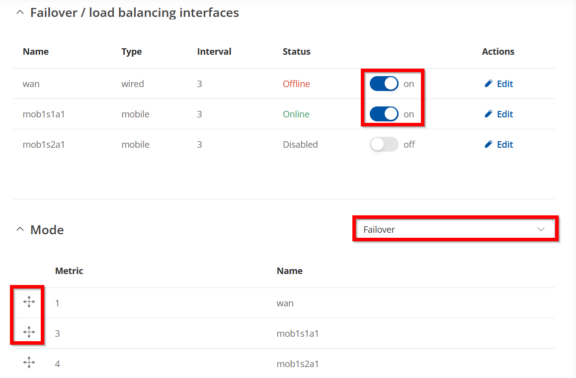

I doubt that your ISP-provided router has failover functionality, but the RUTX50 does, and it can be configured quite easily. You just need to plug a LAN cable from your ISP router’s LAN port to the RUTX50’s WAN port, then go to Network → Failover and ensure that failover functionality is selected. Adjust the metrics according to your preference and ensure that failover interfaces are enabled.
This should be sufficient if you’re using the Teltonika router as your main one. I can’t provide advice about your ISP’s router since I lack knowledge about what kind of device it is and if it even has the appropriate functionality.

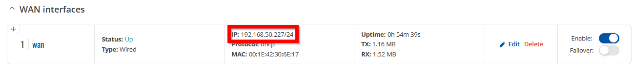

Thanks for getting back to me. I have my router from my isp which is a linksys SPNMX42 connected to the internet. I have a cat6 cable running from one of the lan ports on the isp router to the Wan port on the RUTX50. I have also removed all sim cards, so as to remove any mobile Internet, but I have no connection to the internet. Even if I plug the internet cable from my ISP, directly into the wan port on the RUTX50, i still have no internet connection. What am I missing here,

That would be the ideal solution for me, to use the RUTX50 as the fail over router, connected to my isp router as the main router. But at this point in time, zi cant even get the RUTX50 to connect to the internet with the isp cable pugged into the Wan port of the RUTX50. On the wan interface page, its shoes the Status as being up, but I still cant access the internet. Google does not load.

I have now reset the RUTX50 to factory defaults, connected my usp cable to the wan port of yhe RUTX50, ran through the setup wizard, and still no internet. On the Status/Overview page, the Wan section is all blank. I have spoken to my isp, and they have said there is nothing in place from there side that would restrict any sort of usage of third party routers. Could this router be faulty, I dont know, but I need to get this resolved please.
There might be an issue with the router, of course. Please check the cable; try using another one. Do the LEDs on the WAN port light up when the LAN cable is connected to another router? Additionally, you could try upgrading the router to the newest firmware.
It was updated yesterday, i have 2 cables all brand new. When its connected to my isp, the wan lights up, but no internet just lan.
