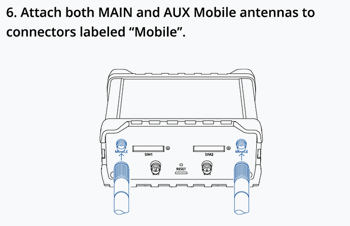

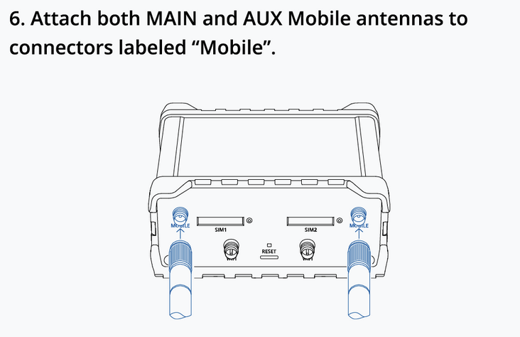

To set up the mobile connection, please attach the mobile antennas to the router at a 90-degree angle. Insert a SIM card into either SIM slot 1 or slot 2 (the default is slot 1). If you wish to use slot 2, you will need to set it as the default SIM in the WebUI under Network → Mobile → General → SIM2. More information can be found here: SIM card settings.

For mobile connectivity and better signal, make sure to attach both mobile antennas
at a 90-degree angle, as shown in the YouTube video.
