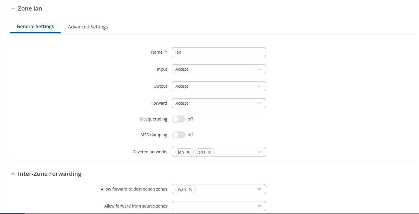

Can you expand on what inter-zone forwarding are the correct ones? Because of the tutorial I mentioned above, I assumed the defaults would already make it work.

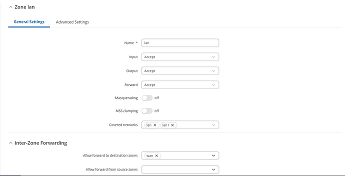

The image below shows what the defaults give me, where I already see “lan” and “lan1” defined here.

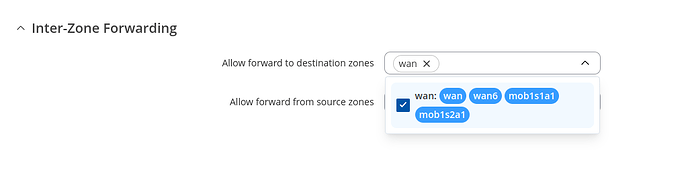

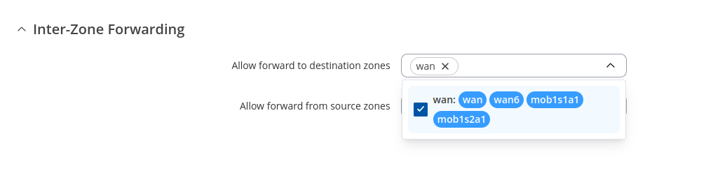

For info, if I press the field under “inter-zone forwarding” I also do not see the option to add lan or lan1 to the inter-zone forwarding.
@Ewoud Hello,
Inter-zone forwarding is used to control access between different firewall zones. In your screenshot, both LAN and LAN1 are part of the same lan zone, and the firewall configuration currently allows traffic from this lan zone, which includes both LAN and LAN1 networks, to be forwarded only to WAN. No other zones are permitted to send traffic to the lan zone. You can modify these settings as needed.
Another important setting is the “Forward” option, which is currently set to “Accept.” This determines how traffic is handled within the same firewall zone. Since both LAN and LAN1 belong to the lan zone, setting “Forward” to “Accept” allows traffic to flow freely between them. If you change it to “Drop” or “Reject,” traffic between LAN and LAN1 will be blocked. This option specifically manages communication within a zone but between different networks inside it.

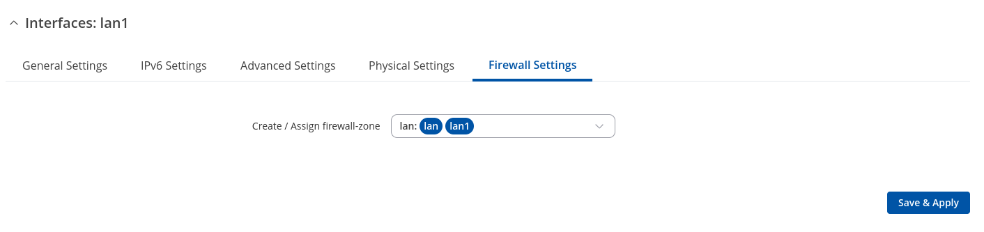

To troubleshoot your issue, I recommend reviewing the VLAN interfaces you created and checking which firewall zones they are assigned to. You can find this under Network → LAN → Edit your desired interface → Firewall tab.
@AndzejJ Hello,
They are assigned to the same firewall zone, see image below. This is the default setup.
Is this correct?
@Ewoud Hello,
Yes, it should be fine. Since the interfaces are in the LAN zone and the “forward” option is set to Accept within that zone, traffic should be allowed - unless there are additional traffic rules configured that might be blocking it (but I assume you did not configure any additional traffic rules). If everything is left as default, it should work. This suggests that the issue is likely related to routing.

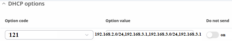

You’ll have to do metric modification on end-device. An alternative could be pushing specific (static) routes via DHCP option 121, that should work on most up to date end-devices nowadays.
Try to add DHCP option 121 for port 2 (192.168.3.0/24 subnet) and specify the routes which must be reached via Teltonika router (192.168.2.0/24, 192.168.4.0/24, 192.168.5.0/24…).
I think it should look something like this in GUI DHCP server settings.
Basically, the idea is:
  1. Specify DHCP option
  2. Fill in subnet which needs to be reached, fill in gateway
  3. Separate all new entries with comma
I don’t know if the syntax is correct, don’t really have a device to test this myself, but that would be one way to control end-devices routing from Teltonika’s perspective. Otherwise you’ll have to set lower metric on all end-devices to prefer Teltonika as the default gateway.
