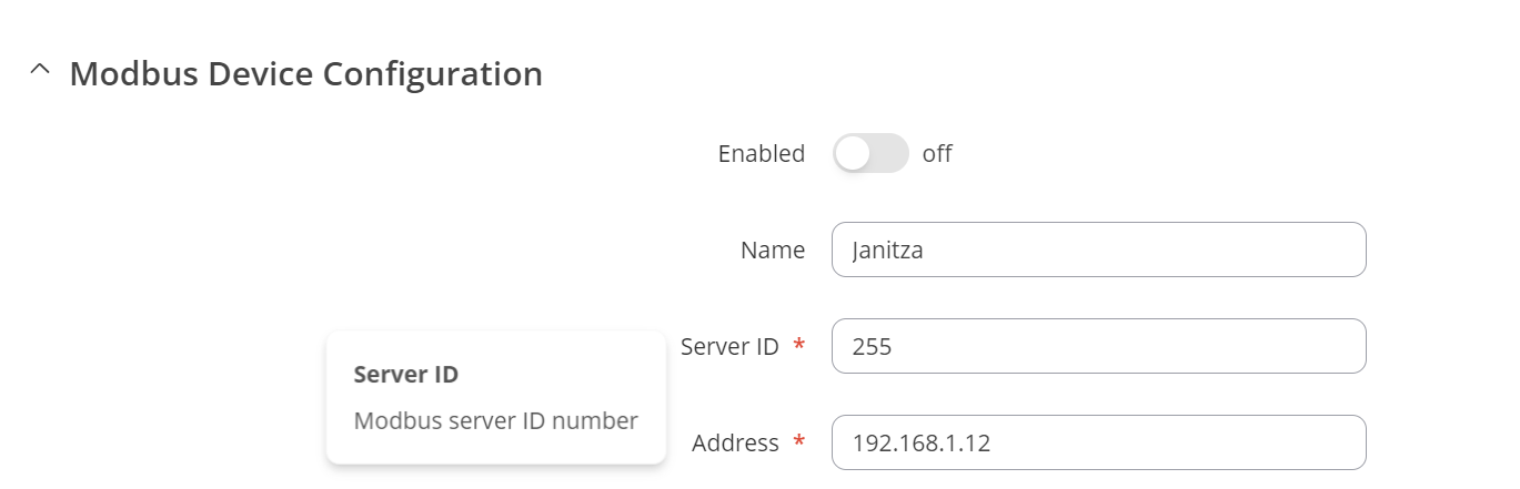

I want to connect a power meter with an RUT241 via Modbus TCP, read out the values and send them via the “Data to Server” feature to a MQTT broker. I have done so with various meters and it works perfectly.
However, what always gives me headache (and now with a new meter acutally blocks me) is the required Server ID field.
The Server ID is often the same for the same meter models / manufacturers, however, we connect sometimes to already existing setups, where the ID could have been changed. I assume this is now the case. I do not get a connection, already tried some obvious IDs which ususally work (e.g., 1-10 and 248-255).
In the wiki (e.g., here Modbus TCP Master MQTT Gateway - Teltonika Networks Wiki), it states that one can set the Slave ID to 0 in order to repond to all adresses. However, the field only allows values from 1-255.
