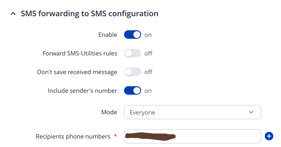

I have a RUTX50 and a RUTX11 located in other European countries, and they both automatically forward any SMS messages as an SMS to my UK mobile and my email address.
All of this is easily configurable in the devices Web UI, and can forward the recieved SMS to multiple recipients.
You can also configure the device to only forward messages from certain number(s). A brief description of the configuration parameters can be found here.

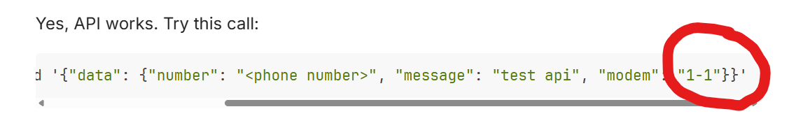

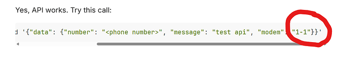

Yes, API works. Try this call:
POST /messages/actions/send '{"data": {"number": "<phone number>", "message": "test api", "modem": "1-1"}}'
Be aware that the modem id will vary, depending on the device model. For instance, on a RUTX50 it is 2-1. You can retrieve the modem id using api GET /modems/status
The correct value will be shown next to the “id”: in the returned data set.
update:
My bad, was using GET instead of POST.
