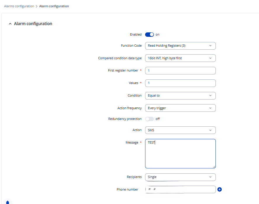

I am having a RUT 200 and Modbus slave device which is connected as Modbus TCP/IP slave.I need to send an SMS along with Modbus register value whenever the register value changes.I am able to communicate with Modbus device and tried to send a SMS by using Alarm configuration but it allows only Text no provision to add register value.
Please let me know is there any way to send register value also.

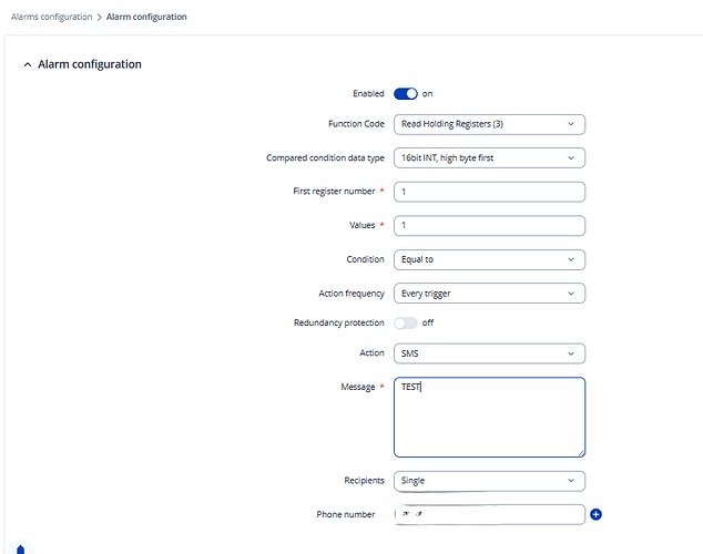

Hi, please remove your image since it contains your phone number.. or blur ir out and re-upload it.
SMS content you send is usually static (whatever message you send is what you’re going to get).
For your desired use-case, you’ll 100% need a custom script to be used, you can’t achieve this normally via the WebUI. To my knowledge, Teltonika Support doesn’t provide support with custom scripts, so you’ll have to make one yourself.
