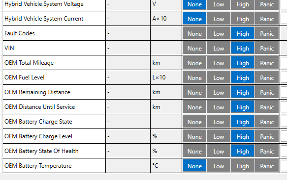

I have set some OBD parameters in “High” priority, but still couldnt get those “High” priority parameters in flespi.
below are the json i received on flespi “etc” column

OEM parameters depends on the vehicle brand model and year make, kindly visit our page for more info: OBD supported vehicle list - Wiki Knowledge Base | Teltonika GPS (teltonika-gps.com)
