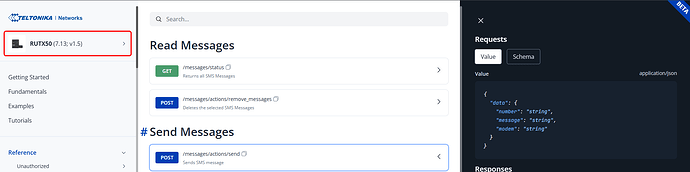

Depending on your used device, you can choose the device with FW by pressing on the field shown in the screenshot below:
