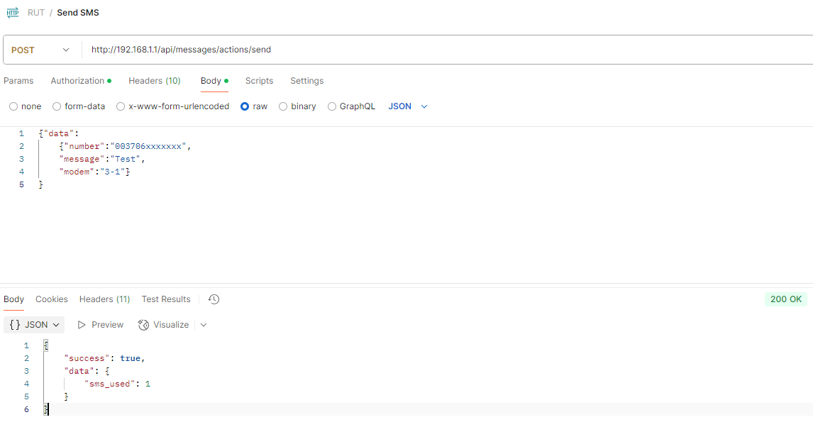

From Postman application, it can look as follows:

Many thanks for your answer and clear instructions. This indeed worked perfectly on my local network.

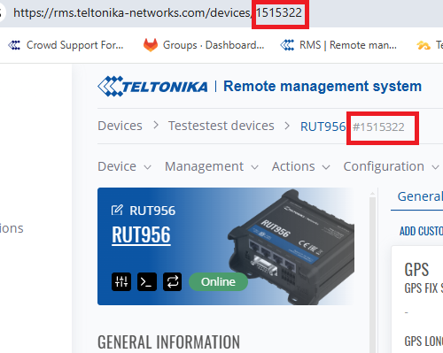

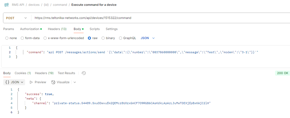

In Postman, you need to use the following endpoint:
  • https://rms.teltonika-networks.com/api/devices/<Device_RMS_ID>/command
Then you need the following message body:
"command": "api POST /messages/actions/send '{\"data\":{\"number\":\"0037060000000\",\"message\":\"Test\",\"modem\":\"3-1\"}}'"
For example:

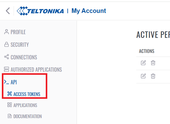

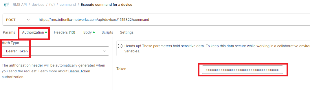

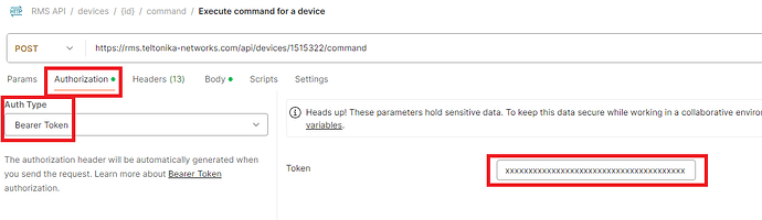

Do not forget that you also need to generate an authentication token from your RMS account settings page:
And apply it before executing the API call:
