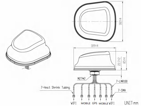

no i mean the mounting screw. I would like to print an extension for the caravan roof.
The screw is M27. Here are some quick dimensions to help guide your 3D print. Good luck with printing it!
I will give it a try. Thank you
