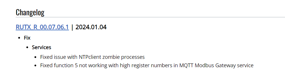

Thank you for bringing this issue up to us. I just wanted to let you know that we were aware of this issue and we already implemented a fix on it through firmware RUTX_R_00.07.06.1.
Kindly update your devices to this FW version. - RUTXR1 Firmware Downloads - Teltonika Networks Wiki
