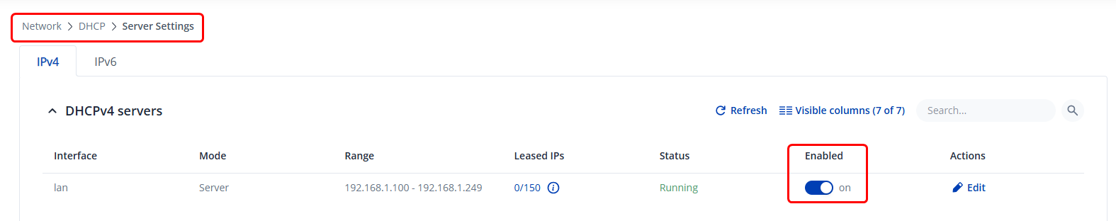

Next, under Network → DHCP → Server Settings, could you confirm that the server is enabled? If it’s disabled, this could very well cause the devices to either connect/disconnect, or not connect at all:

I disabled the option you suggested. Let’s see if it works. DHCP is enabled. As for the logs, I’ll keep an eye on them now. Thanks, I’ll let you know.
