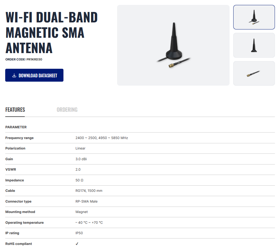

The antennas included with the RUTX50 are identical, as shown below:
They have the following specifications:
You might be considering using an antenna with a higher dBi value. However, it’s important to note that a higher dBi value doesn’t necessarily mean universally better coverage. Antennas with higher gain (e.g., 7 dBi, 9 dBi) typically offer improved coverage for distant devices, while antennas with lower gain (e.g., 2 dBi, 5 dBi) are better suited for devices in close range. This is because the antenna port receives the same signal power.
It’s worth mentioning that we haven’t tested our routers with 15 dBi antennas, as they weren’t designed for use with such high gain antennas. While they may work, to accurately assess coverage and other specifications, we recommend conducting your own tests.
To add antenna you are reviewing has different not compatible connector to our router, you’d need solution for that. Additional point: these antennas are only suitable for 2.4GHz, while RUTX50 support 2.4GHz and 5GHz Wifi.
