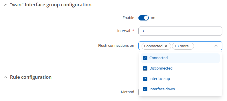

Could you please check whether the “Flush connections on” options are selected for both your wired WAN and mobile failover interfaces under Network → Failover → Multiwan → “edit” on both interfaces?
Flush connection on options
If they’re not, I’d suggest enabling them for both interfaces and observing whether this improves the situation. This setting clears existing connection tracking entries, which can otherwise sometimes cause stale or mismatched routing states when interfaces switch.
Additionally, please ensure your device is running on the latest (7.15.2) or mass production (7.14.3) firmware.

No interface had any flush connections on; they are now all set to on.
I will not be able to tell if flushing the connections makes a difference until I have been away a few times and the wifi light has not stayed on: it only used to happen about once in five trips but I will feedback in the future.
