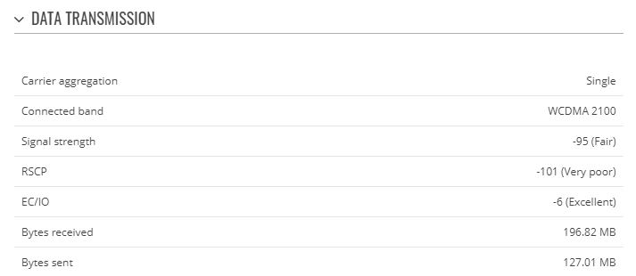

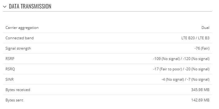

Here is also connection data for LTE, network type now “Auto”.
I will test LTE to see if the short connection drop-outs still continue.
LTE worked for 45min, has been offline since 22:48 last night. Auto reboot is on and action is to restart modem doesn’t seem to help. I can see from my other device close by, Wi-Fi module is on but no internet via Wi-Fi. I will switch back to 3G if it comes back online.
Since the logs do not indicate any disconnections from the mobile network, I highly doubt that the issue is within the RUTX50. I can however see that the WiFi clients disconnect, which could indicate a connection loss, as most modern phones disconnect from WiFi if it does not have internet access.
LTE signal is truly very poor, so I don’t think it’s worth even investigating the issue on LTE.
What I would recommend doing, is navigate to Services → Auto Reboot → Ping/Wget reboot, configure ping reboot, but as an action specify “Do nothing”. This way the router will not reboot (thus preserving the logs), but it will also print informational messages in the logs indicating that pings were not successful. Please post the logs the morning after this setting was configured. Thank you.
