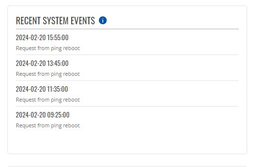

Awnsering my own thread.
The RUTX50 crashes/goes down continually.
However I have noticed it does not seem random.
Look at the timestamps for Request reboot. It is exactly 120 minutes between the drops.
I see the same pattern further back in time. Last24H, 48H, etc.
Does this make any sense, and cout it lead to pin-pointing the root cause?
SYS_LOG
