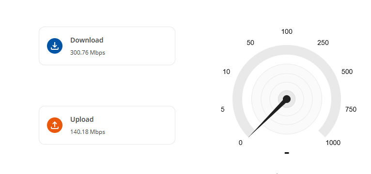

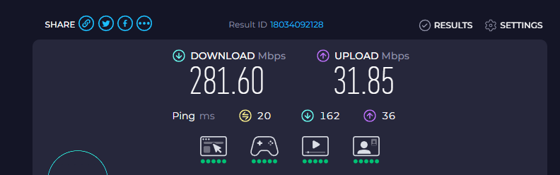

i’ve got this weird phenomenom. While using the RUTx50 to connect with the mobile network with 5G i get very low Uploadspeeds. The integrated Speedtest seems to work fine with aprox. 300Mbps Download and 140Mbps Upload but when I go for an independent Speedtest i get 280Mbps Download and 30Mbps Upload. If I try to upload some of my files which are over 2GB it gets slowed down even more down to 4-12Mbps which takes ages. The downloadspeed is always fine.

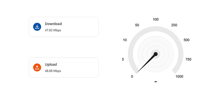

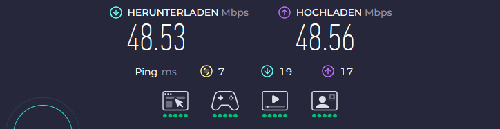

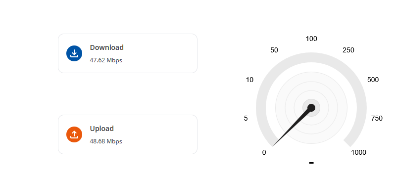

I then tried to connect the router via Wi-Fi Client as my main WAN instead of mobile and everything seems to be fine, I get 50Mbps Down- and Upload and my files load with an equvilant speed.
