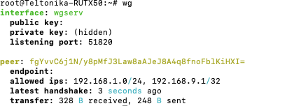

Just execute wg from a ssh or CLI console.
The wg command outputs nothing before, during or after establishing the VPN connection.
So the vpn is not started ??? Even on the responder (the RUTX50 according to a previous post).

Turns out using the name “default” was not good (I thought it was a wireguard-specific name). I changed the name of the wg interface, and now the wg command does show something.
Still no traffic through in either variation.
At least the tunnel is established this time received and sent counters have positive values.

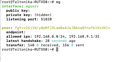

What is the output of wg at the other end ?
Actually I don’t know. The wireguard server IP address is set to 192.168.9.1/24.
So I should include the public IP in the allowed IP list? Of the client? And/or the server? Or does “the address of the remote endpoint” mean something else?
Was set to Accept/Accept/Reject, masquerading on. Changing to the above did not help.
The other end is a mac client. Not sure how to get the wg output, except from the log as I sent earlier. Also it is difficult to get from both, as I am using the same client device to access both, but changing connection to test the tunnel.
