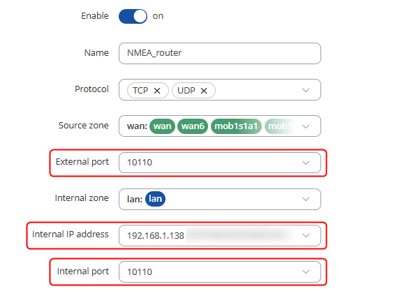

The port forwarding rule could be set up similarly to the example shown in the screenshot below, assuming port 10110 is used for NMEA data transmission.
