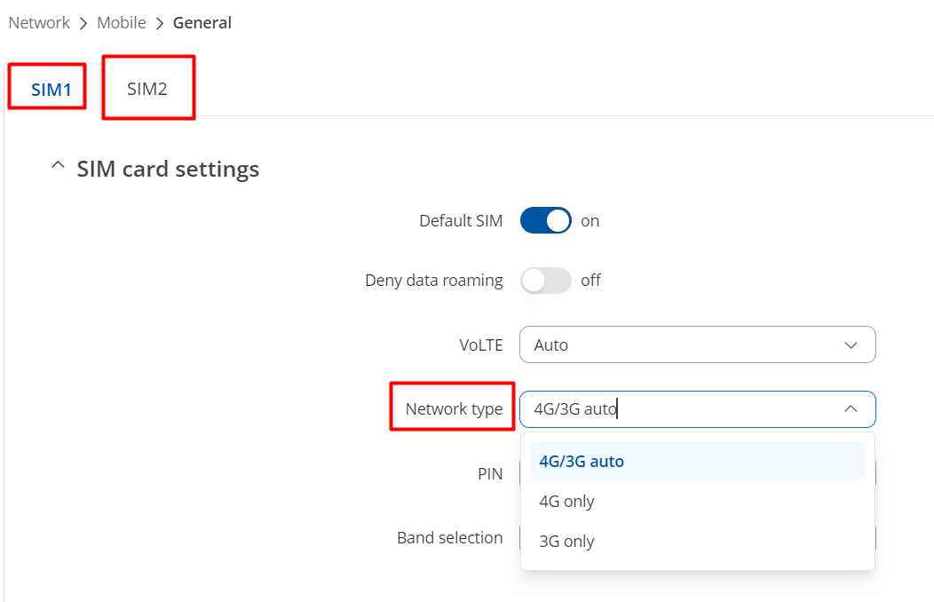

Regarding Set the fallback from 5G to 4G thats depends on your type of network scenario you want to sets on the SIM cards, you can set it manually or auto (Default) as per the screenshot below:

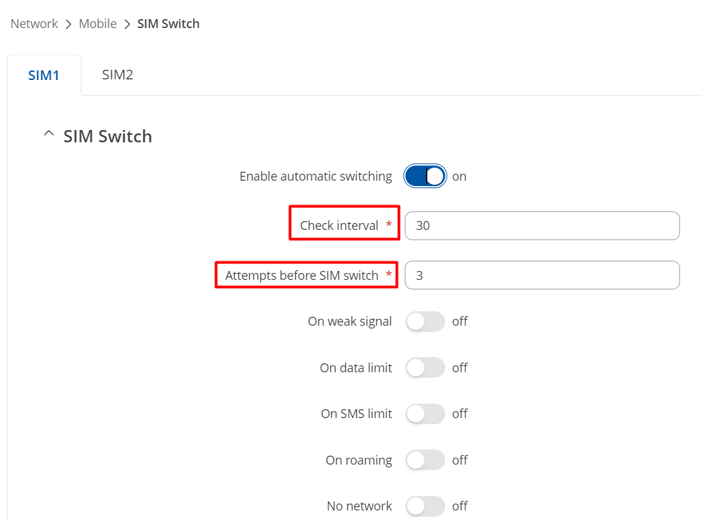

Anyway I have activated sim swich but when I made a report I see that it was a down time of 5 minuties for the last 24 hours. It didn’t change sim card then. Any idea of what setting that I have done wrong?
Please double-check the configurations on the SIM switch, such as the interval and the number of ping attempts before switching to the backup sim, for example, if the device is a state that meets at least one SIM switch condition, the device will perform a number of additional checks specified in this field and will perform a SIM switch only if the condition is met on every check.
