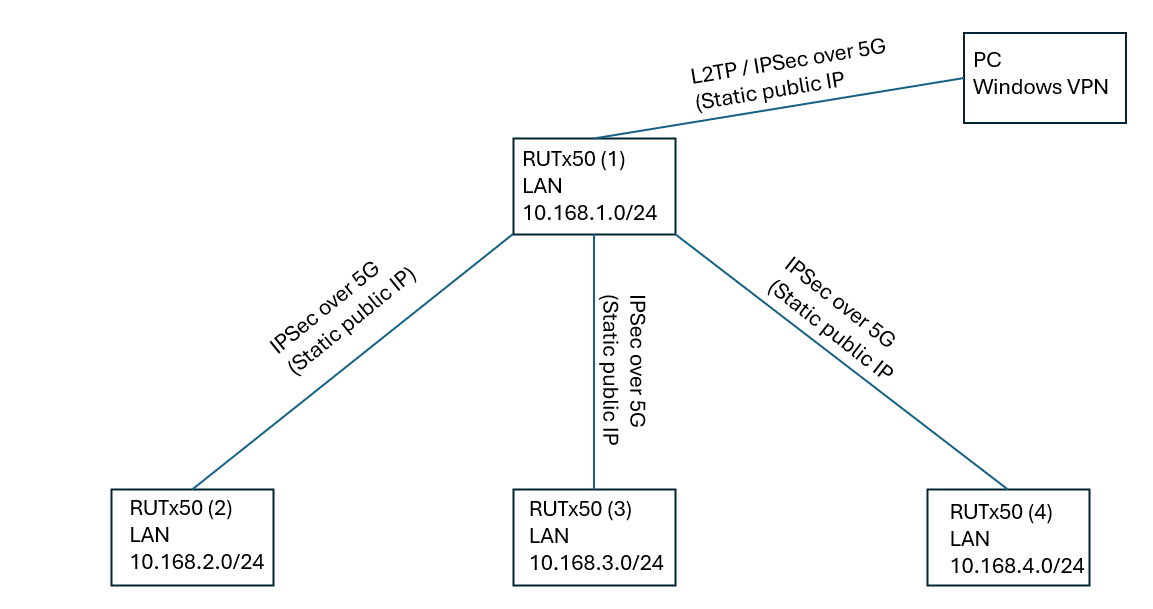

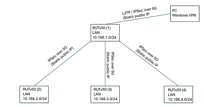

I am experiencing connectivity issues trying reach devices connected to a RUTX50 client via IPSec between a RUTX50 server and a RUTX50 client from my pc using vpn l2tp/ipsec
Details:
Communication from the server to the client works correctly.
However, when I try to access the client network from my PC, the connection fails.
Network Overview:
RUTX50 (1) Network → RUTX50 (2) Network: OK
RUTX50 (1) Network → RUTX50 (3) Network: OK
RUTX50 (1) Network → RUTX50 (4) Network: OK
Client → RUTX50 (1) Network: OK
Client → RUTX50 (2, 3, 4) Network: Not OK
Any ideas what i might be missing

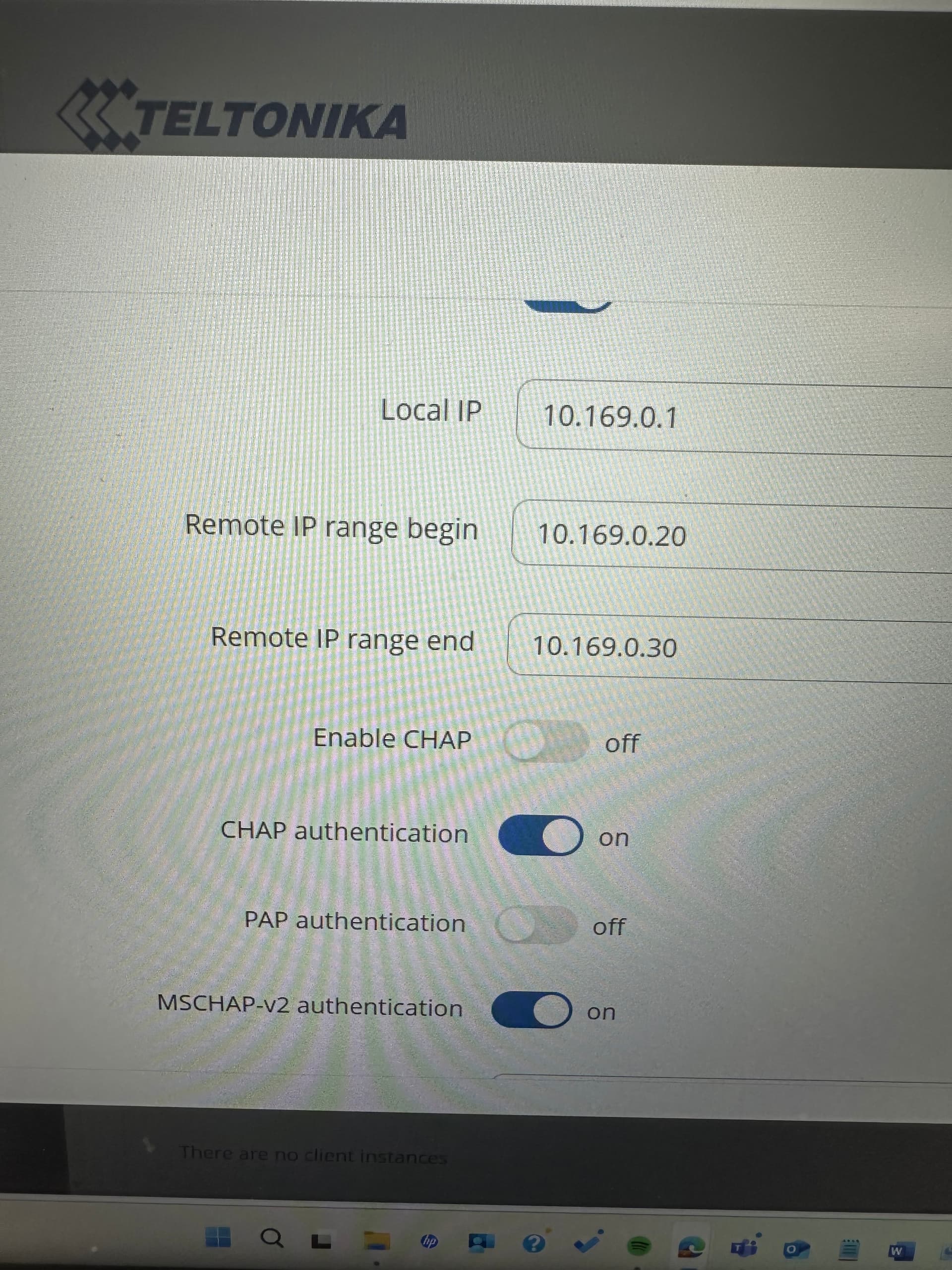

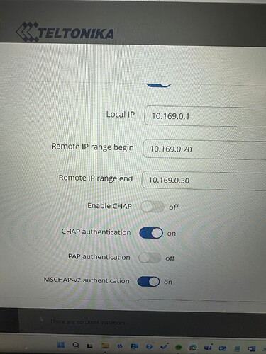

Hello
Cant find this setting , this is what i have
Hello..
Please… check the RUTOS of your device.
Also… check for basic / advanced mode for old RUTOS release…
Don’t need to update your box… just change from basic to advanced and check for the option l2tp default route.
