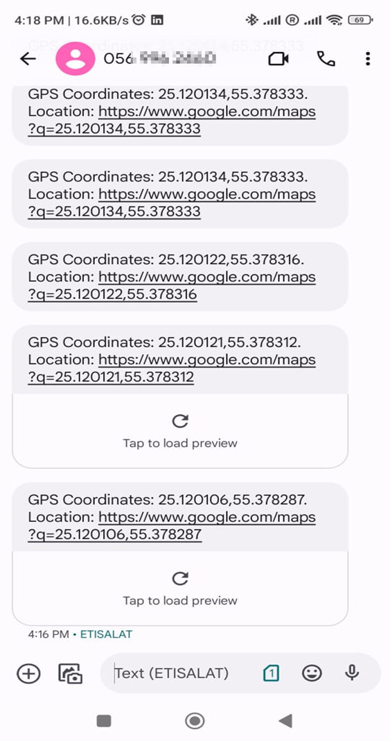

Thank you for getting in touch. I’ve developed a customized script for transmitting GPS coordinates via SMS.
To send emails, you can refer to the information provided in this link: Sending emails via command line - Teltonika Networks Wiki
  • Connect the device: Connect to your device using Putty.
  • Open the script file using the vi-text editor.
vi /sbin/gps.sh
  • Create Script: Copy and paste the following script into the text editor:
#!/bin/sh
# Get latitude
LATITUDE=$(gpsctl -i)
# Get longitude
LONGITUDE=$(gpsctl -x)
# Check if both latitude and longitude are available
if [ -n "$LATITUDE" ] && [ -n "$LONGITUDE" ]; then
    # Your logic to handle the GPS coordinates
    GPS_COORDINATES="$LATITUDE,$LONGITUDE"
    # Create a Google Maps link
    MAPS_LINK="https://www.google.com/maps?q=$GPS_COORDINATES"
    # Add your SMS sending logic here
    # For example, using gsmctl
    gsmctl -S -s "+97156xxxxx GPS Coordinates: $GPS_COORDINATES. Location: $MAPS_LINK"
else
    echo "Error: GPS coordinates not available."
fi
  • Save the File: After editing the script, save the changes and exit the text editor.
    In vi, press Esc, then type:wq and press Enter.
  • Make the Script Executable: Ensure the script is executable by running the following command.
 chmod +x /sbin/gps.sh
  • Executed the following command for testing purposes.
./sbin/gps.sh
Test Result:
Thanks,
Mahmoud

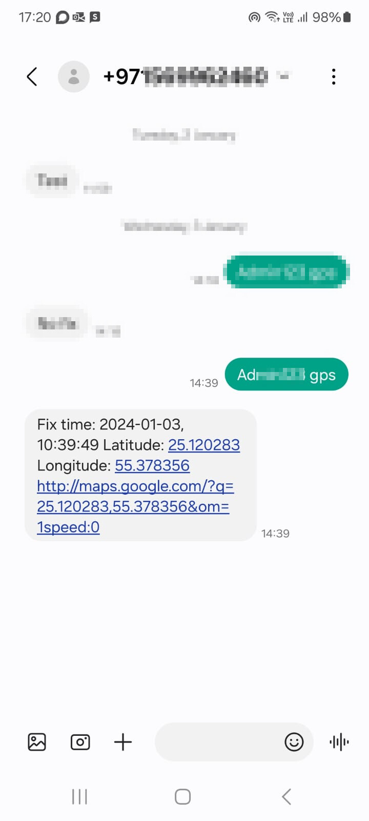

If you don’t require a script, you have the option to directly send an SMS to the SIM number within the router. The router will then provide the GPS coordinates in response.
Router-Password gps
Thanks,
