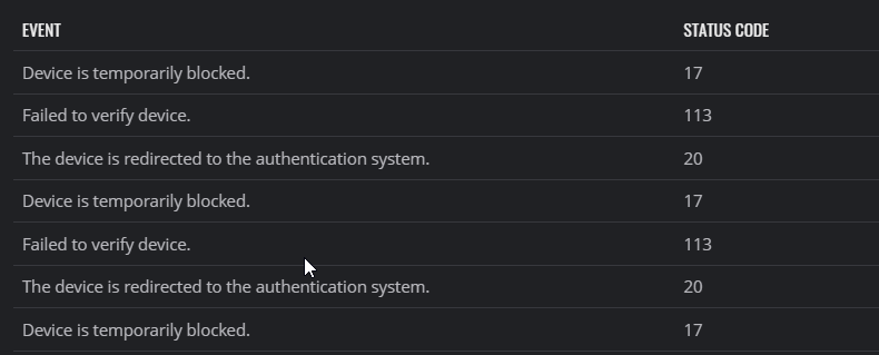

Factory reset later and got it all working, however now the device is unable to connect to RMS.
RMS indicates it is offline, unable to authenticate and gets temporarily blocked, then repeats the cycle.

Device detail tab;
