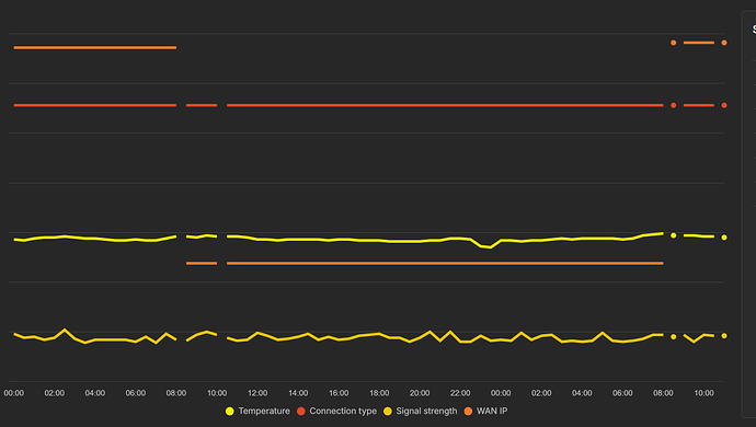

  • The primary WAN interface is mob1s1a1, using SIM1 on a 5G-NSA connection via 3Ireland.
  • Over the last 30 days, we’ve seen daily disconnects, typically at 20:07, where the WAN goes down and reselects the same mobile
  • On 4 June 2025 at 08:17, the system reported the WAN down again, this time triggering a short-lived data outage and DNS disruption.
  • These events correlate with dnsmasq reinitializations, leading to temporary DNS resolution failures for dependent services.

  • Extracted and analyzed system.log, event logs, and failover logs.
  • Found no major hardware faults or modem driver issues.
  • DNS instability appears tightly coupled with link resets or dynamic IP assignments from the ISP.

Thank you for providing a detailed description of the issue.
  1. Please try the solution suggested in this community post to prevent mobile disconnections: RUT240 Mobile connection drops every 2 hours - #12 by Marija. If the issue still persists after applying the steps, let me know and I’ll contact you privately for further assistance.
  2. Regarding SIM switching – to alternate between SIM1 and SIM2, please use the SIM Switch function instead of Failover. You can find a detailed explanation on how to configure it here: RUTX50 Mobile - Teltonika Networks Wiki
Please let me know if this resolves the issue or if you need any further assistance.
