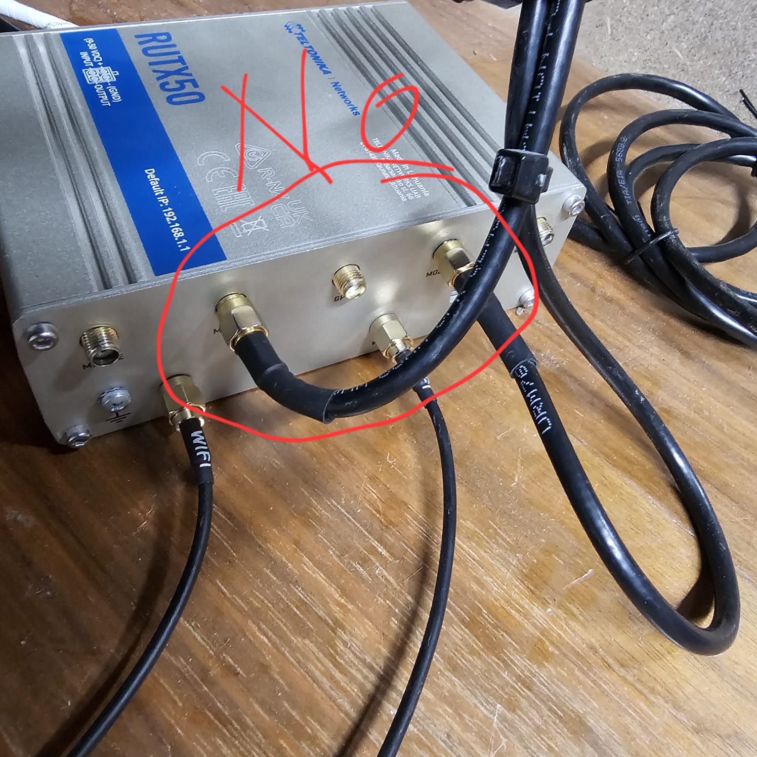

as input pictures above, whats the point of the 4 inputs if only 2 work? there doesnt seem to be any gain difference. I have this issue on 4 RUTX50 routers 2 of which use the 5G XPOL Poynting 4x4 … 1 using 2 x Fullband FBXPMIMO 8dbi cross polarised outdoor & the last using the internal antenna supplied. is there configuration for these ports or a specific way to connect as have tried multiple variations often with 4 ports connected signal gets worse! Additional to this 5G only seems to pick up when the outer left is connected??
any help advice would be appreciated,

All SMA ports work, but if your base station operates in only 2x2 MIMO mode, the modem will only use the first and second SMA connectors on the left, the other two SMAs are used if the base station operates in 4x4 MIMO mode.

also - have now tried the internal plastic aerials that come with unit and there is little difference between them and the external aerials??
