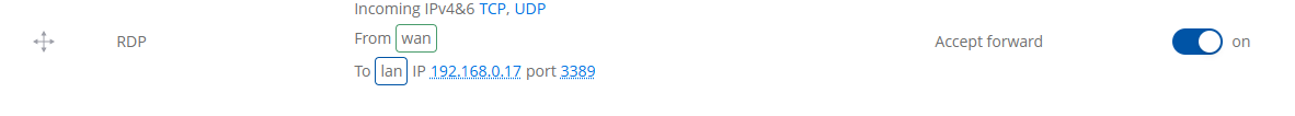

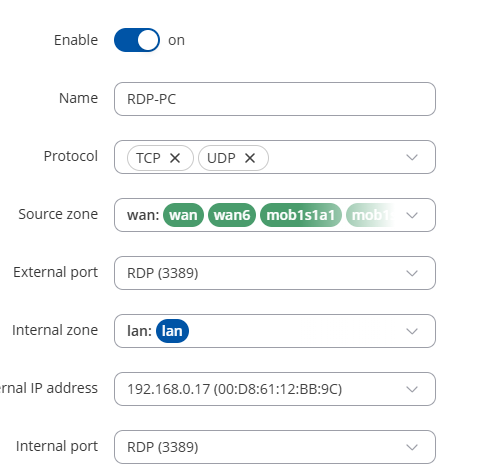

Port forward rule in Firewall setup see image

With all this setup I cannot access the PC via RDP, it works internally on the network but not externally. Port Checker also shows the port is closed.
I am missing something?

  1. Your SIM card is providing private IP. IP is NAT’ed by mobile provider thus router cannot be reached using this IP. You need special SIM card (mobile plan) to provide public IP so router could be reached using that IP.
  2. You are looking for port forward rule not a traffic rule.
