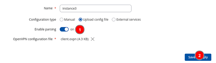

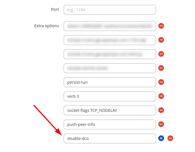

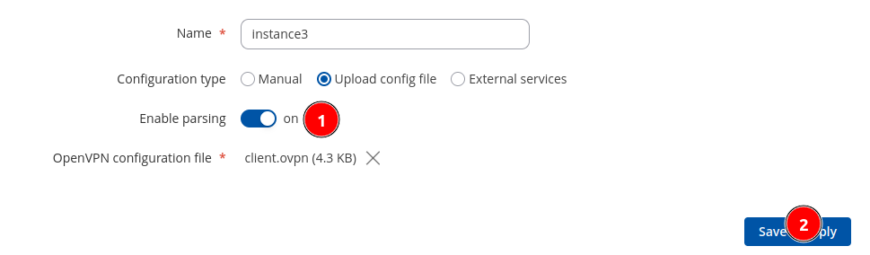

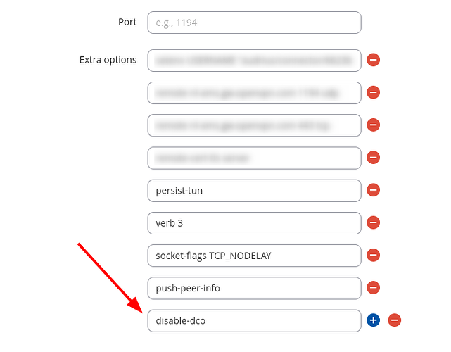

Yes, this is a known issue currently under review by our R&D team, and it’s already on the list to be addressed in a future firmware release. Unfortunately, I don’t have an exact timeline for the fix at the moment.
In the meantime, there’s a straightforward workaround you can apply:
  1. Enable Parsing in your OpenVPN client configuration:
  2. Add the disable-dco extra option to the client’s configuration:
    Save & Apply.
