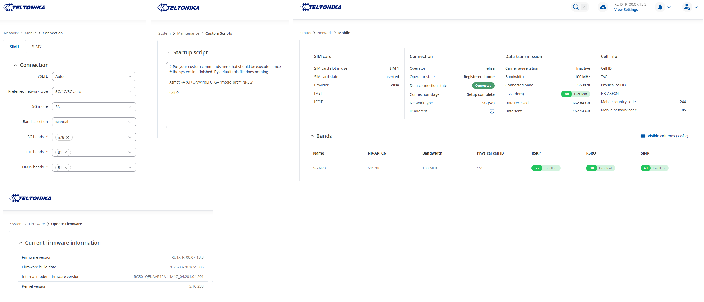

Yes, correct. Does the device not stay connected to 5G SA even after this command is executed?
This is current setup and status and yes it seems to stay on 5G SA N78. I check it regularly though as I have learned to not trust it to do it’s own thing after a while :laughing:
It could be that RutOS is overwriting the 5G lock during modem reboot or connection reestablishment. If that’s the case, you can always use the WebUI configuration to force 5G SA, and in the 4G and 3G specify the bands that aren’t available in Europe. For example, for LTE I’d select B42 (as it’s used in private deployments-only), and since 3G was shutdown by Elisa, any band can be selected.
Yes good point I read that 3G is available on the ƅland Islands only now. And good tip on 4G B42 so I will try that. I guess given the setup now it should stay on 5G SA N78 but I will be checking it regularly anyway. Thanks :wink:
