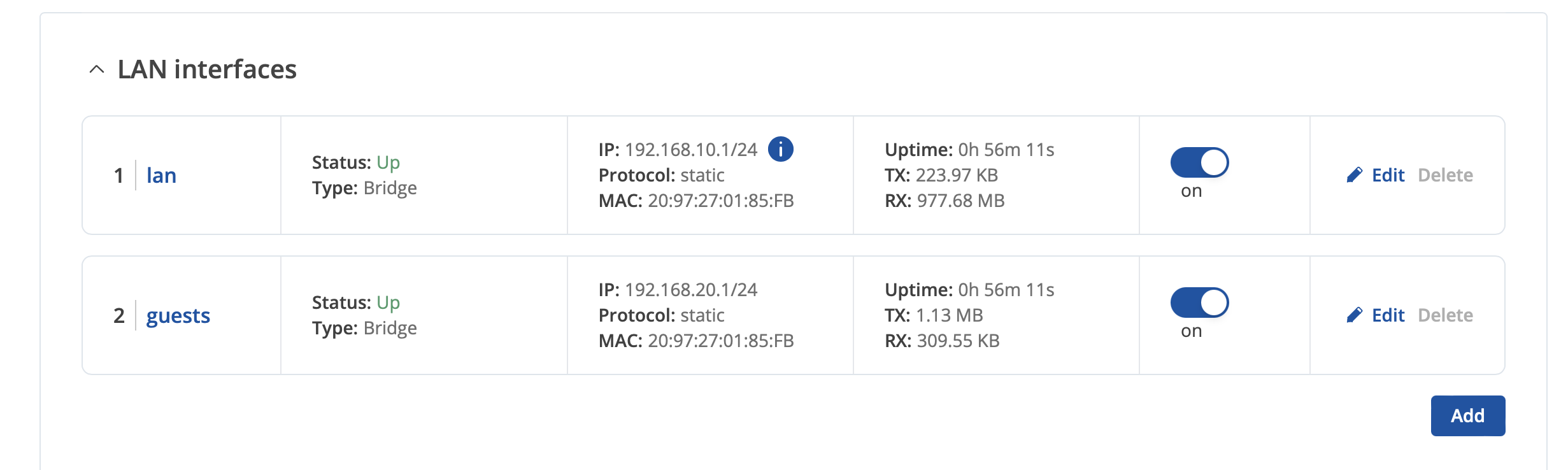

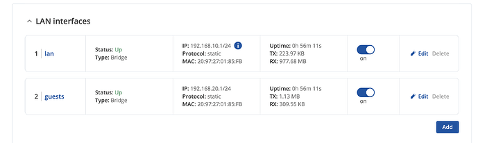

I have recently upgraded the boat to a RUTX50, and I have a couple questions on the network/wifi configuration. The idea is to have a main “lan” network (with a admin wifi) with all the boat’s devices on it, and a “guest” one, with wifi, for people to connect to. This second one shouldn’t be able to communicate with “lan” apart from a few specific ip/ports.
Now, I have everything mostly working, but I do have a couple of questions:

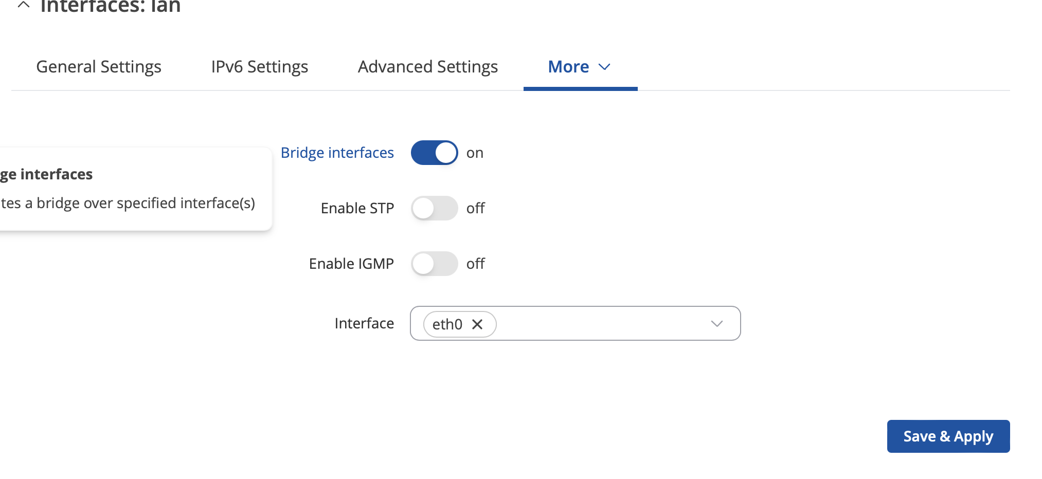

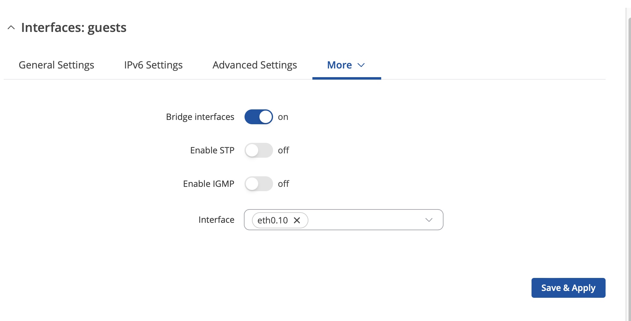

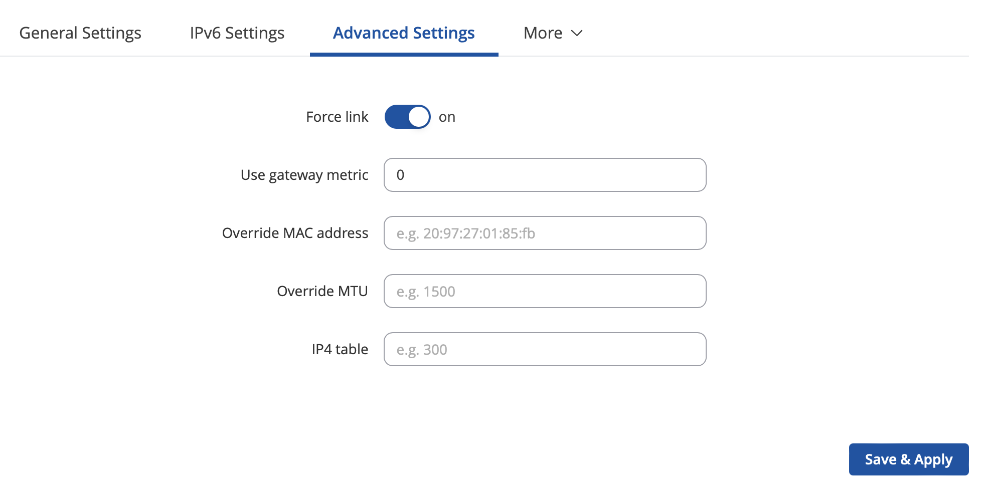

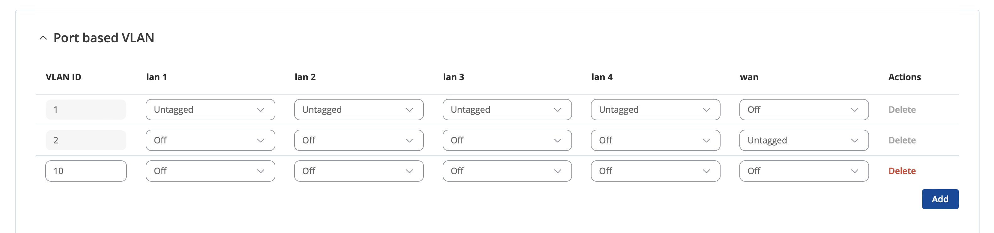

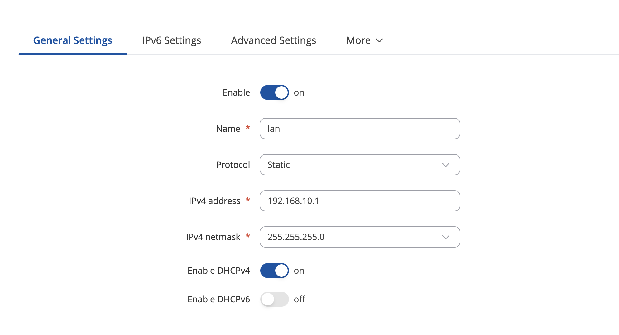

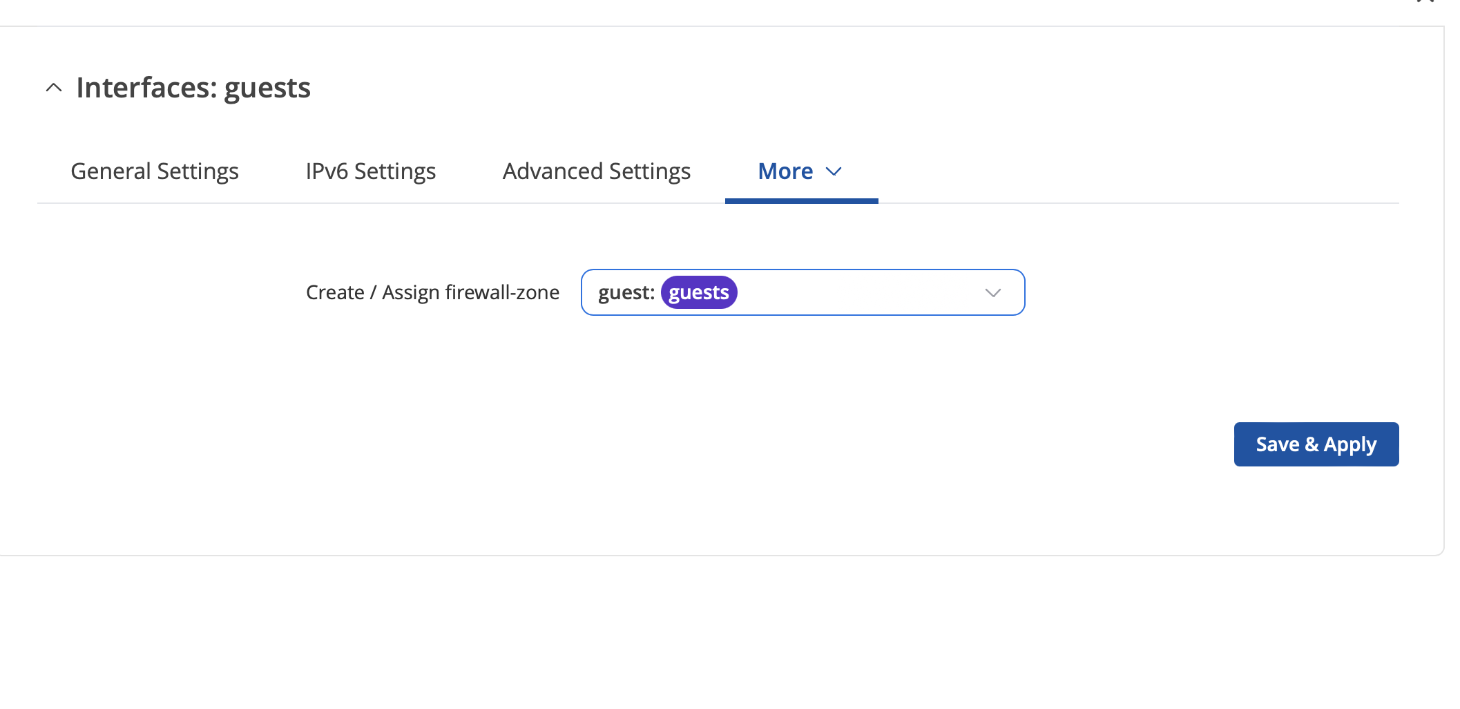

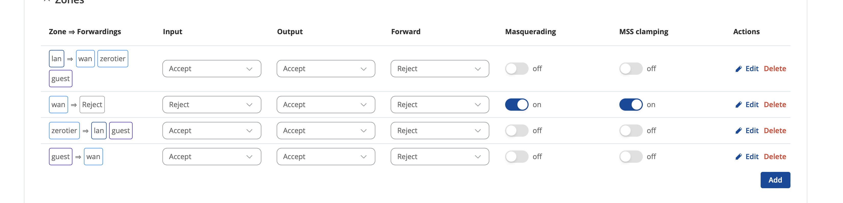

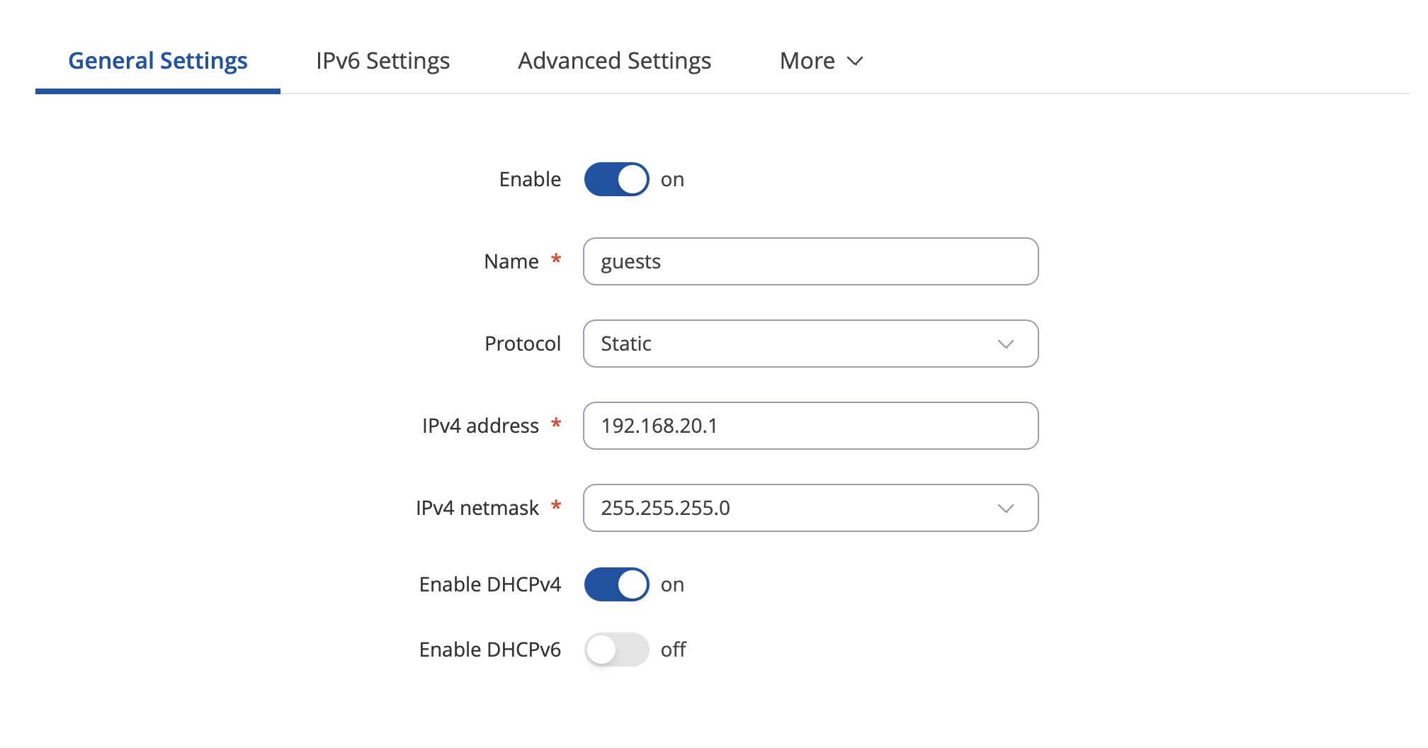

until i switched both interfaces to bridge mode, wifi devices were not getting any ip from the dhcp servers, and even now the dhcp servers seems to randomly stop working fow wifi devices until a reboot. Why is bridge mode needed? And why might it be unreliable?
Is this the correct way of doing this (attaching pictures)
I am on firmware 00.07.07.1.
Thank you

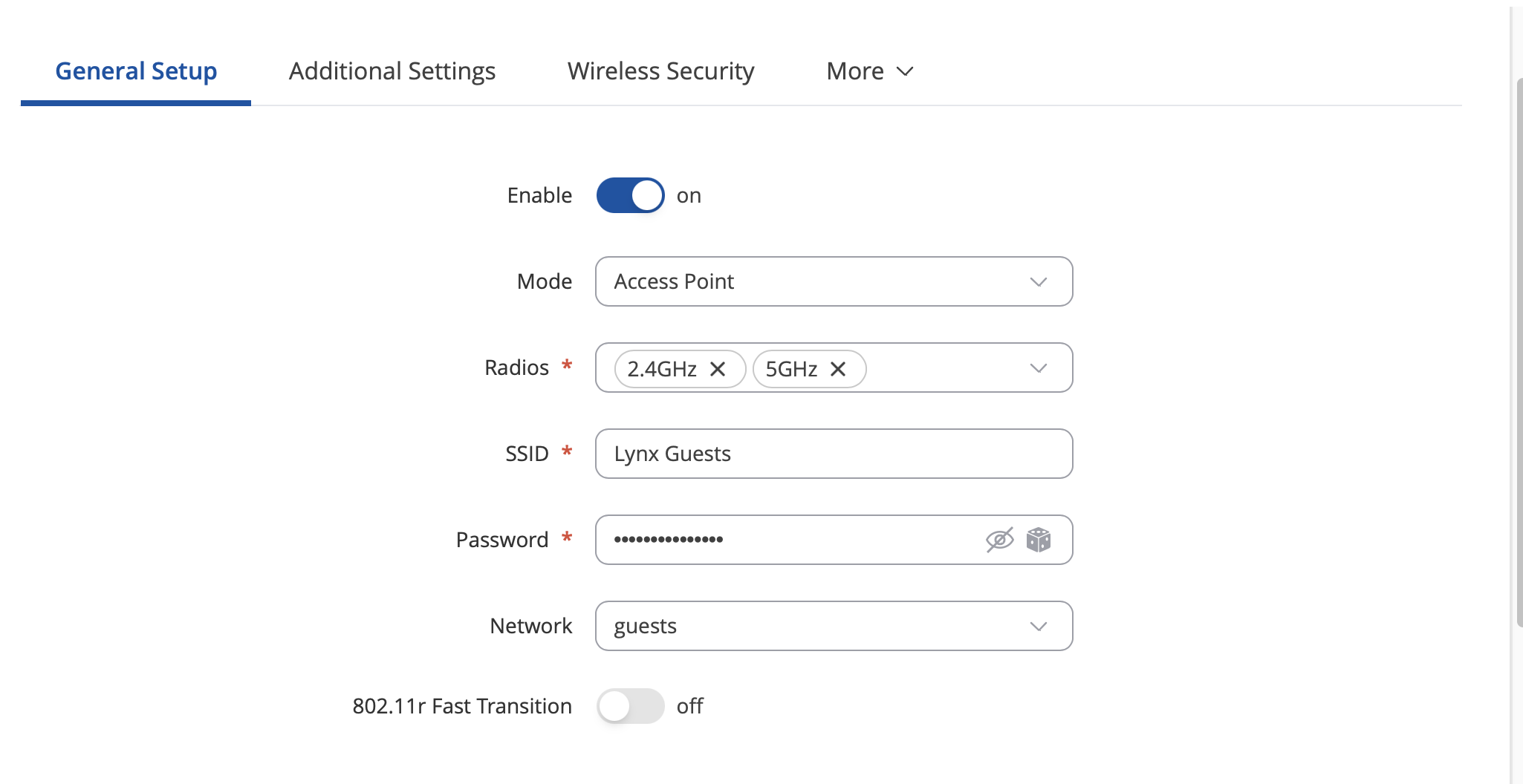

Without bridge mode you can attach network interface only to one device. In example “guests” (wlan1).
When you are configuring VLAN with ethernet ports and attaching two radios (2.4Ghz and 5Ghz) under the hood you are connecting at least 3 devices for example: (eth0, wlan0, wlan1). So the bridge is necessary to connect all of them into one group.

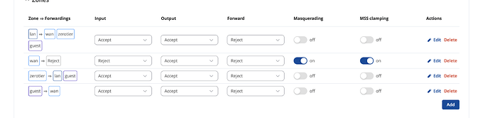

Yes, looks good.

Ahh I see. I was missing the part where the various frequency were actually separate interfaces.
I say unreliable because the other day it stopped working again until a reboot. If it happens again I will check (and attach) the log. Even when I was having the problem the dhcp server status was good, which is why I was confused.
