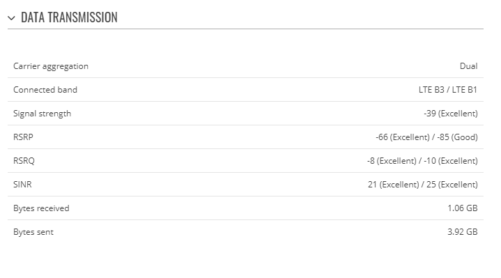

Anyway signal is improved from -60/70dbm to -38/40dbm and I thought is fine because if you use single antenna like the original is the same I think.

In that case, these antennas can also be used. I should also note, that other signal parameters are also important when determining connection quality, maily the RSRP (should be above -100dBm) and SINR.
Ohh yes i know. I think better then this i cant do :sweat_smile:
