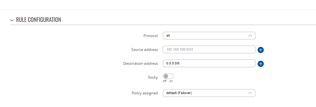

Hi, is this policy enough to LB based on source ports whether TCP/UDP if the source IP address is the same i.e 192.168.0.2 with traffic coming only from a single LAN port?
I would of course enable the LB thereafter, I’m just wanting to know the OS behaviour since I have this configuration/design.

The rule you’ve shared shows a default failover rule rather than load balancing. Additionally, it’s configured to apply to all protocols, meaning it will apply to all types of traffic, including TCP, UDP, ICMP, and so on, for failover.

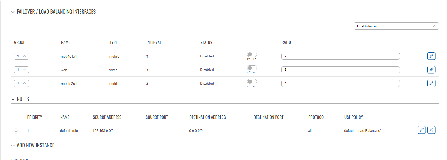

This is the current config
I will enable them once my wired service is brought up of course, does it look correct?
Also, how does the ratio work like 3 would be 60% and 2 would be 40% what’s the calc for 70/30 or 80/20?
I just want to make sure it’s correct.
also, what’s the default behaviour if my wired service is brought up i.e mobile first then wired? when I’ve not enabled the load-balancing yet…how does the routing priority work when you have two default routes 0/0 in the route table
Yes, you can define the ratios in the following manner: For a 70/30 split, use the format 7-3, and for an 80/20 split, use 4-1. If you wish to balance between mobile and wired WAN connections, simply enable “mob1s1a1” and “WAN” for load balancing.

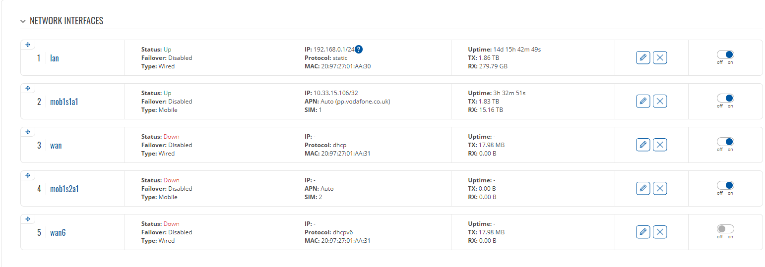

Thanks all good info but my question is related to if there is no failover or no load balancing configured, then how the route tables select the mobile or wired (pppoe metric 1) service for the 0/0?
If you refer to the order of the interface in Network → WAN (not failover/load-balancing), then, the interface listed at the top holds the lowest metric and, as a result, takes priority. As you move down the list, the metrics increment. Therefore, the interface at the bottom of the list will have the highest metric, so it will not be used as a default route because it has a higher metric, unless other interfaces are unavailable.
The metric can be confirmed by editing a specific interface and navigating to advanced settings, where you can see the metric. On the same page, the default gateway specifies that this interface can be used as a default route for internet access.
So if you want to used pppoe WAN as your main connection, make sure to drag WAN interface to the top of the list in Network → WAN.
