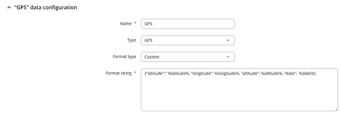

Unfortunately, the problem remains on my side.
Here is my configuration:

I just wanted to ask whether the issue with improper GPS data payload is still relevant or was resolved. From the Postman Mock Server’s payload, it appears that the received data is formatted correctly.
I contacted support via email, and the issue has now been resolved.
The solution was to add Content-Type: application/json under the HTTP header settings in the server configuration.
