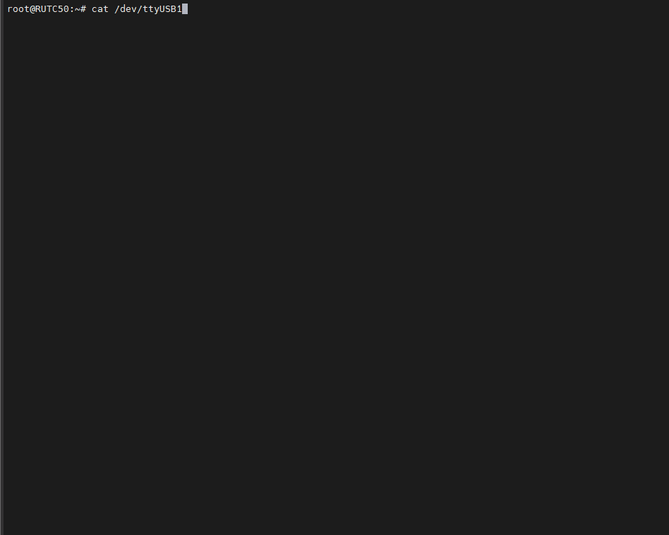

Here is an example of how NMEA sentences are obtained:
2024-07-30

I now tried to make a python program that access the /dev/ttyUSB1
But got this error message: Serial exception: device reports readiness to read but returned no data (device disconnected or multiple access on port?)
and after that not even cat /dev/ttyUSB1 works and I need to reboot the router.
ut this show up correct: ubus call gsm.modem0 info | grep gps
“gps_port”: “/dev/ttyUSB1”,
If I stop the gpsd service the script can connect to the usb1 port but then no data flowing.
Any idé what the problem might be?
If gpsd is not enabled, GPS data won’t be visible. And if gpsd is enabled, it occupies ttyUSB1. gsmctl -A AT+QGPS=1 should start the GPS on the module and gsmctl -A AT+QGPSEND should turn it off without enabling gpsd. In that case you should be able to connect to ttyUSB1
