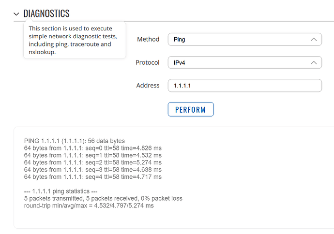

If the lease is there, please navigate to System → Administration → Troubleshoot, and in the Diagnostics section run a ping test to 1.1.1.1. Post the results below.

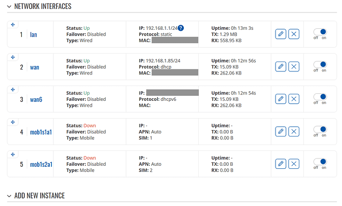

If the pings are still lost, please post a screenshot of the Interfaces page, with the MAC addresses blurred, as well as public IP addresses if any are present (leave the private ones visible).

As requested, here’s a screenshot of the Interfaces page with all MAC addresses and public IP addresses removed, I cannot upload screenshot as I’m a new user, please find link here:
Additionally, here’s the ping test you requested, I cannot upload screenshot as I’m a new user, please find link here:
Interestingly, there are no lost pings in the test results. However, despite this, I’m still unable to establish an internet connection.

  2. Conducted a ping test by navigating to System → Administration → Troubleshoot. The ping test to 1.1.1.1 showed all packets received, as seen in this screenshot:
https://imageupload.io/1RG9PXqvo9bKaCV
However, I still have no internet connection, which is puzzling.

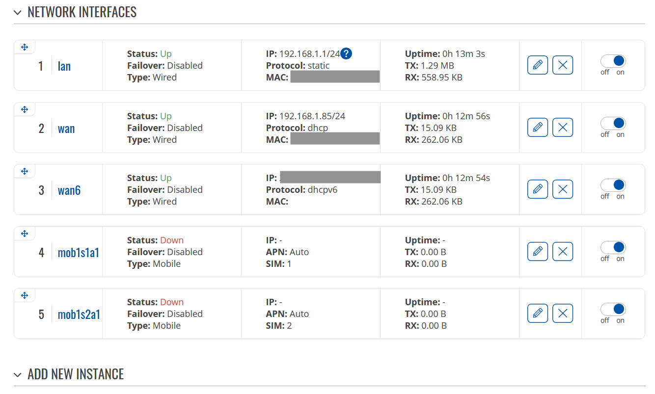

I visited Network → Interfaces → General and took a screenshot with MAC addresses removed and public IP addresses partially removed, but private ones visible. You can see it here:
https://imageupload.io/g36ap6N5cV18qUS

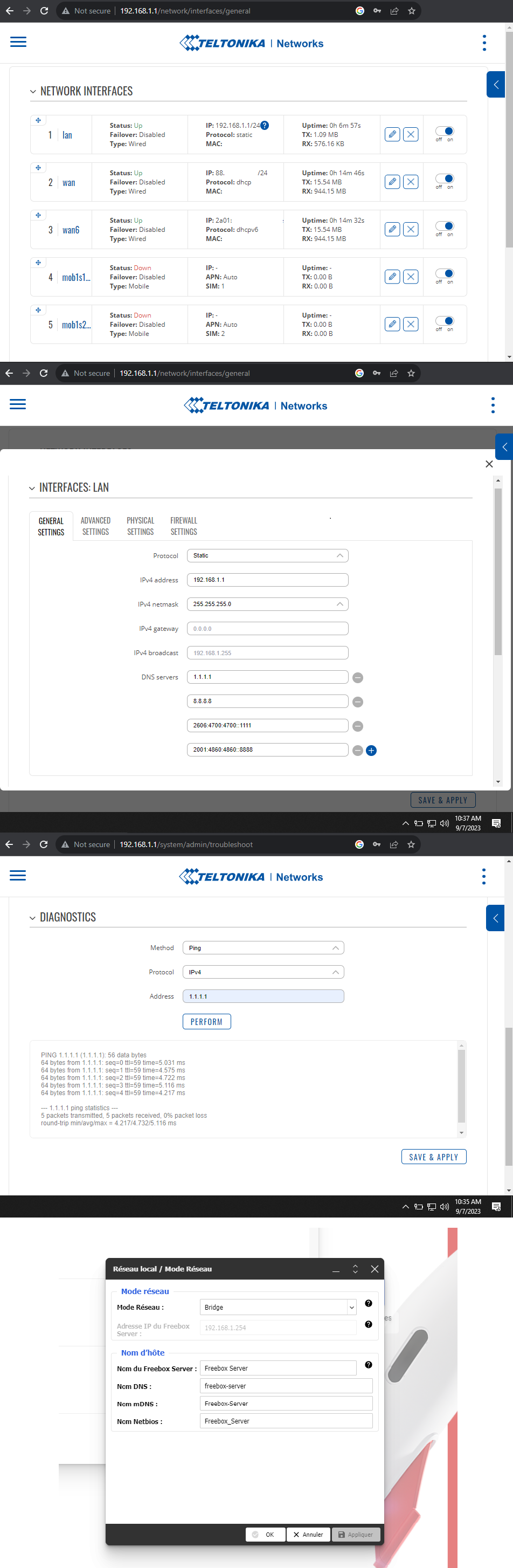

I’ve compiled all the relevant screenshots into one document, to make it easier for you to adress the issue. (Also because as a new user, I can only upload one image/post.)
Order of all screenshots below:
  1. Interfaces
  2. Custom DNS servers
  3. Ping test
  4. ISP-modem in Bridge mode interface
Thank you immensely for your assistance with this matter.
