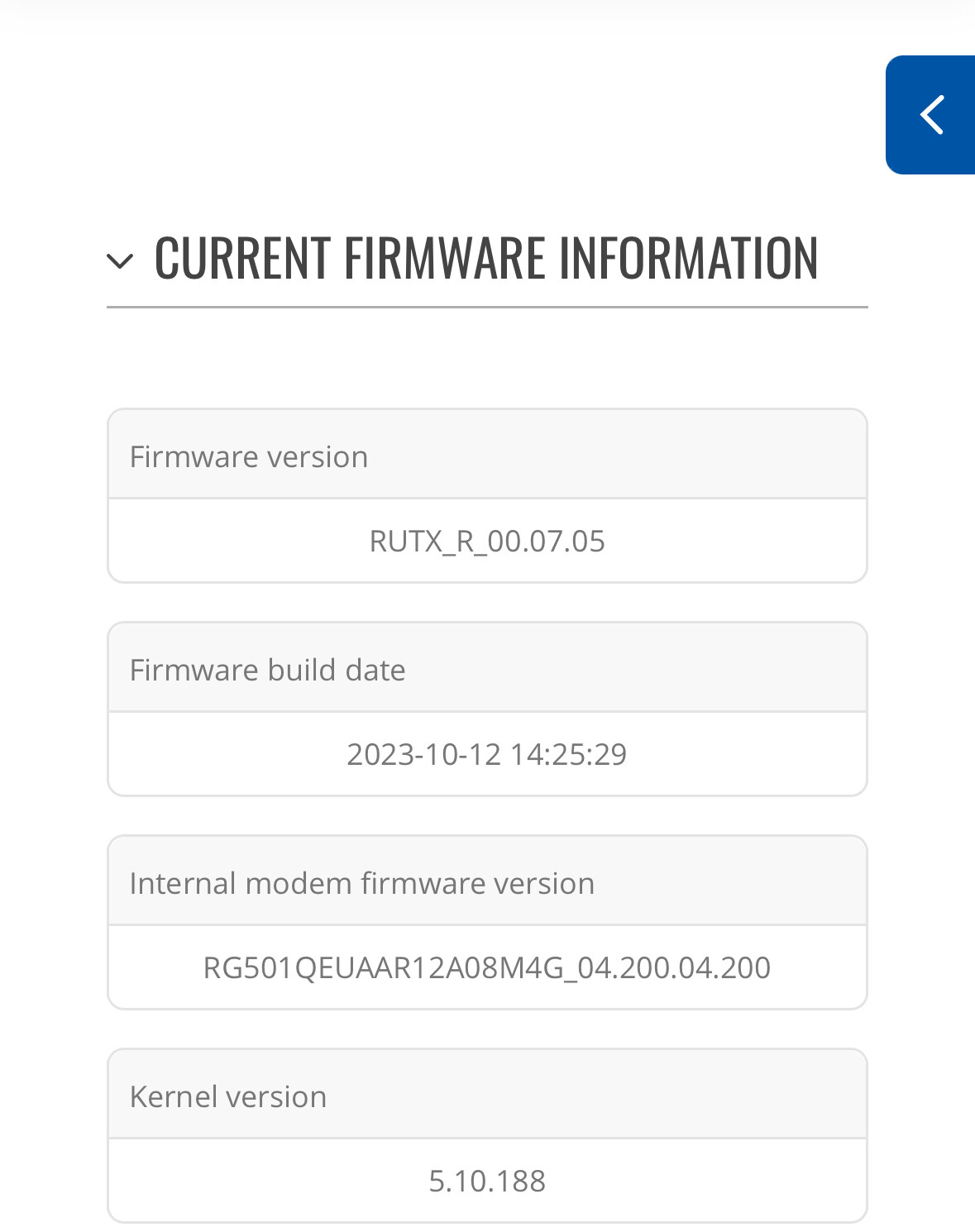

  1. The screenshot you have sent shows that its running FW 7.05, but the latest FW is 7.06 (Release 20/12/2023)

Hello thanks for getting back.
My topic was created before 20/12 release. I have now updated and will test more. Was there a bug fix for hanging routers?
