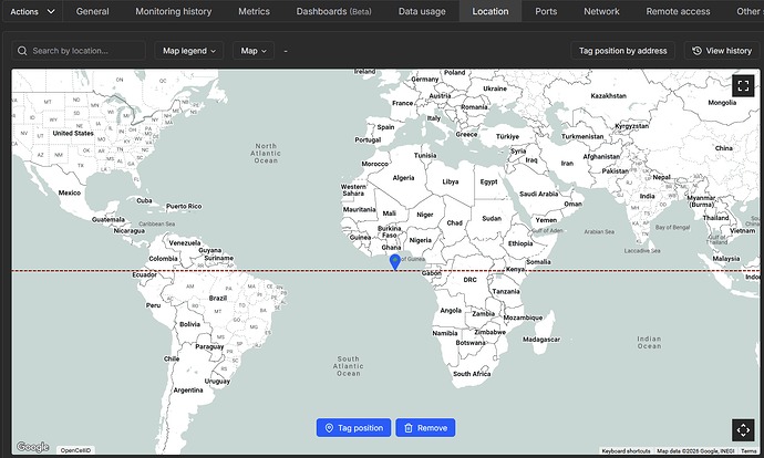

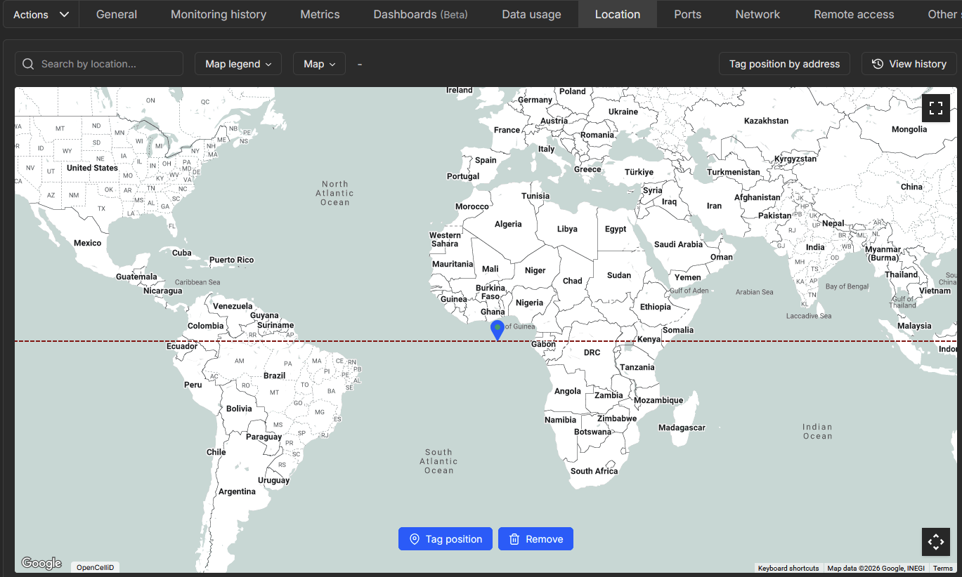

One of the key reasons why I went with Teltonika is the ability to see where the routers’ location is. However, having enrolled the router onto RMS, it keeps showing the location as being in the Gulf of Guinea, to note I am in Ireland.

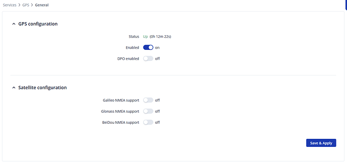

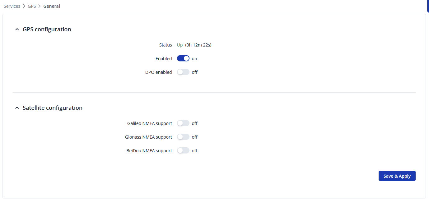

In the router configuration, I initially had the GPS configuration enabled, along with DPO, Galileo, Glonass, and BeiDou. As part of the troubleshooting process with Vilius, we have turned all of these off and back on, turning them all off and only leaving the GPS enabled, but both without success of getting a true location.
The location has now since updated to the correct location, I suspect it just needed a bit of time to refresh after disabling and re-enabling the GPS services.
