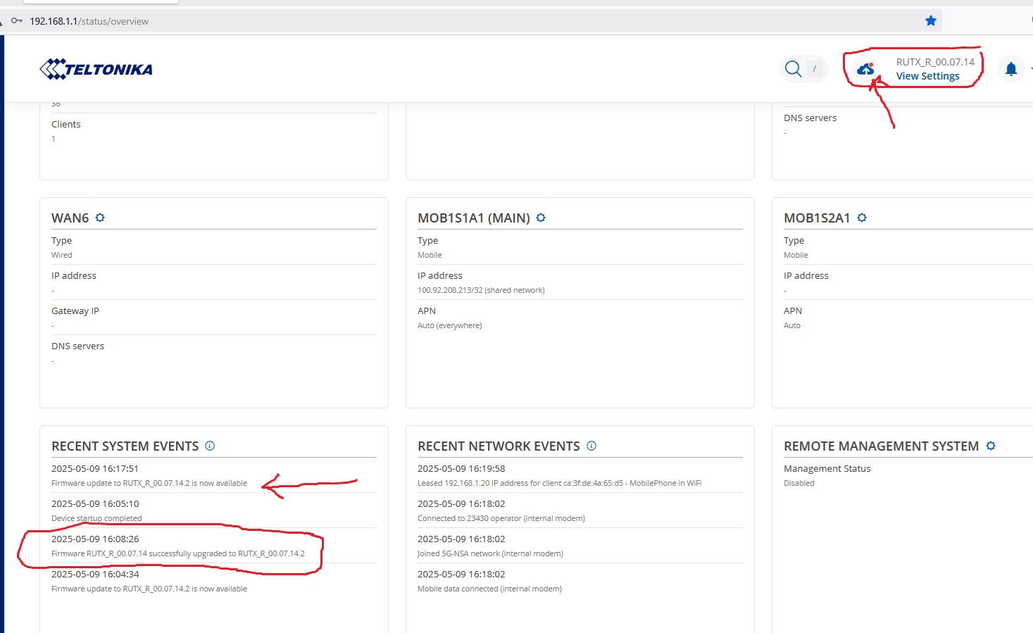

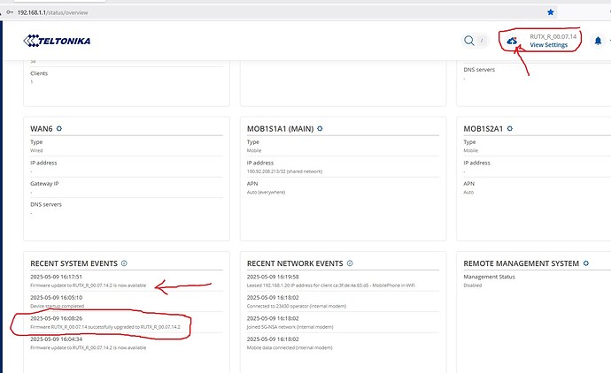

However, in the logs it says the upgrade is successful, but the firmware version is still clearly 7.14 and the UI says an upgrade to 7.14.2 is still available.
