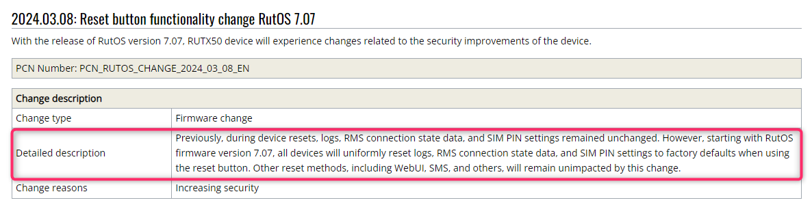

The latest news as of 2024.03.08 are the most accurate. If you sold devices with only a factory reset, unfortunately, logs on these devices are not deleted.
If you want to reset your RUTX50 with firmware version older than 7.07 and don’t want to retain information such as SIM PIN, RMS data, and logs, you can follow these steps to delete this information:

However, there’s a few concerns from my side as you can imagine as those remaining data after a (obviously safe and clean) reset process are still persisting and this has nowhere been mentioned except now as Teltonika announces a major security change in an upcoming firmware version.
Previously, it has been communicated that only SIM-Pin will remain but now it turns out there’s way more surviving a reset procedure? Log files, really???

I completely understand your concern, and I apologize for any inconvenience caused by the lack of information regarding RMS and the retention of logs after a factory reset.
After a factory reset, all information and data are reset to default settings, except for logs, SIM PIN, and RMS data. Previously, these were retained for troubleshooting purposes, but with the implementation of RutOS 7.07, all information will be completely reset for enhanced security. I can confirm that with the new OS, everything is indeed reset, and you don’t need to worry about it.
Regarding the bootloader menu, it doesn’t delete logs and SIM PINs like a factory reset, so if you want to delete this information, you should complete the steps I have mentioned before.
