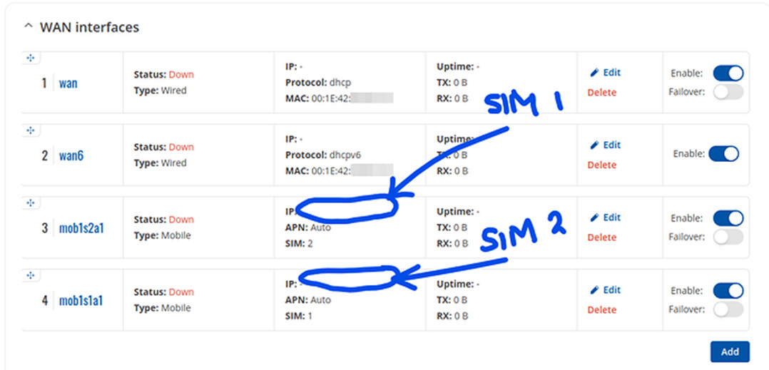

To use DDNS, you need at least a dynamic public IP address. Unfortunately, if you are behind a carrier’s CGNAT, it won’t work. For more information about IP address ranges, refer to the Remote Device Access section.
Please check and provide the first two octets and subnet of the IP address assigned to your WAN interface. This will help determine if CGNAT is affecting your connection.

Although many carriers have both a ‘Public’ APN and a ‘regular behind CGNAT’ APN, the Public APN can only be used if your have purchased a Public IP SIM.
Can we assume you have purchase the far more expensive ‘Public IP’ SIM, or are you using a regular domestic SIM?
To verfy you have a Public IP on your SIM …
Login to the RUTX UI and navigate to NETWORK > WAN > mob1s1a1 … and the IP address should be the same as the one reported in www.ipchicken.com or www.whatsmyip.com
Although it sounds as though you have already established that you have a Public IP, I thought it worth confirming.

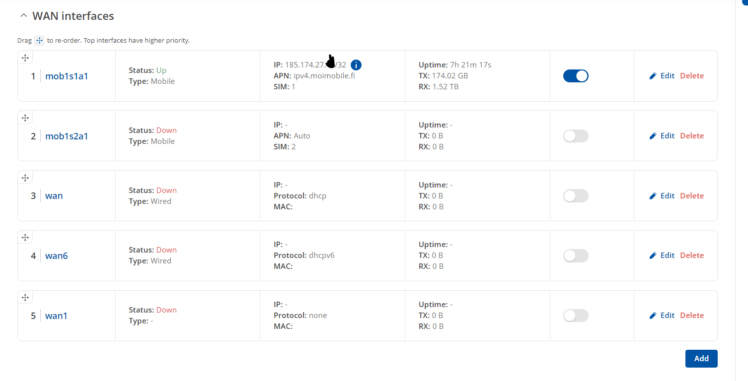

Hi @Mike
Firstly, I want to emphasize that you did the correc thing by trying to check that I am not behind CGNAT, since that is the most common issue!
I just checked the IP from my (Network/WAN) overview screen, and looks like I have an IPv4 address on my mob1s1a1-interface in the subnet that I mentioned earlier. However, looks like the IPv4 address is not always in the same subnet than what the whatismy .com-service provided for me earlier.
It might have something to do with the fact that my ISP is the low cost subsidiary of DNA OYJ, and thus they have access to a different block of those public IP’s :sweat_smile:
I would like to emphasize that I can use the port-forwarded website from within my LAN& when connecting to the site via Duckdns-domain via an VPN, once I have manually updated the public IPv4 addresses correctly to the Duckdns. org-console.

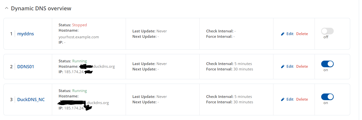

I believe the issue might be with the RUTX50-routers DDNS-client, since it does not update the changed public IPv4 address to the DDNS provider (Duckdns. org). Here is what the DDNS-console on the RUTX50-looks to me:
Please note that I have added spaces to some of the domain-names, since this platform has a limit on links in a single post…

Connect to SSH or open CLI and execute logread. See if any DDNS errors appear, might provide some insights into the issue.
Next step, as this might be a DuckDNS ‘handshake and IP verification’ issue.
Here are my settings … it is sufficient to just enter ‘nouser’ as a Username, as DuckDNS just uses the Domain and their Token as a Password to validate. Ensure you are using the Token that appears on your DuckDNS web login page and not your regular Google password.
More importantly, try http://checkip.dyndns.com as the URL to detect … see if this makes a difference
Be aware that sometimes there can be a small delay for the DDNS to update, so wait a little before checking.
Thanks @Mike
Looks like that fixed 99% of the issue.
The major problem was that I had not signed into the DuckDNS client with just the access token…

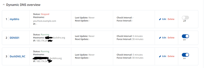

At the moment, I am still encountering an issue wherein the automatically configured IPv4 address is different on the RUTX50 DDNS client Overview page compared to what the checkmyip.dyndns.com & other tools claim it to be. I have also inputted the proper public IPv4 address manually into DuckDNS. org-site.Looks like the two different domains can also have different IPv4 addresses with basicly the same configuration… (I.E. one having the proper IPv4 address, the other not).
Edit:
Looks like the RUTX50 DDNS-overview page IP address display might not be 100% correct, since looks like my windows client gets the correct IP…
