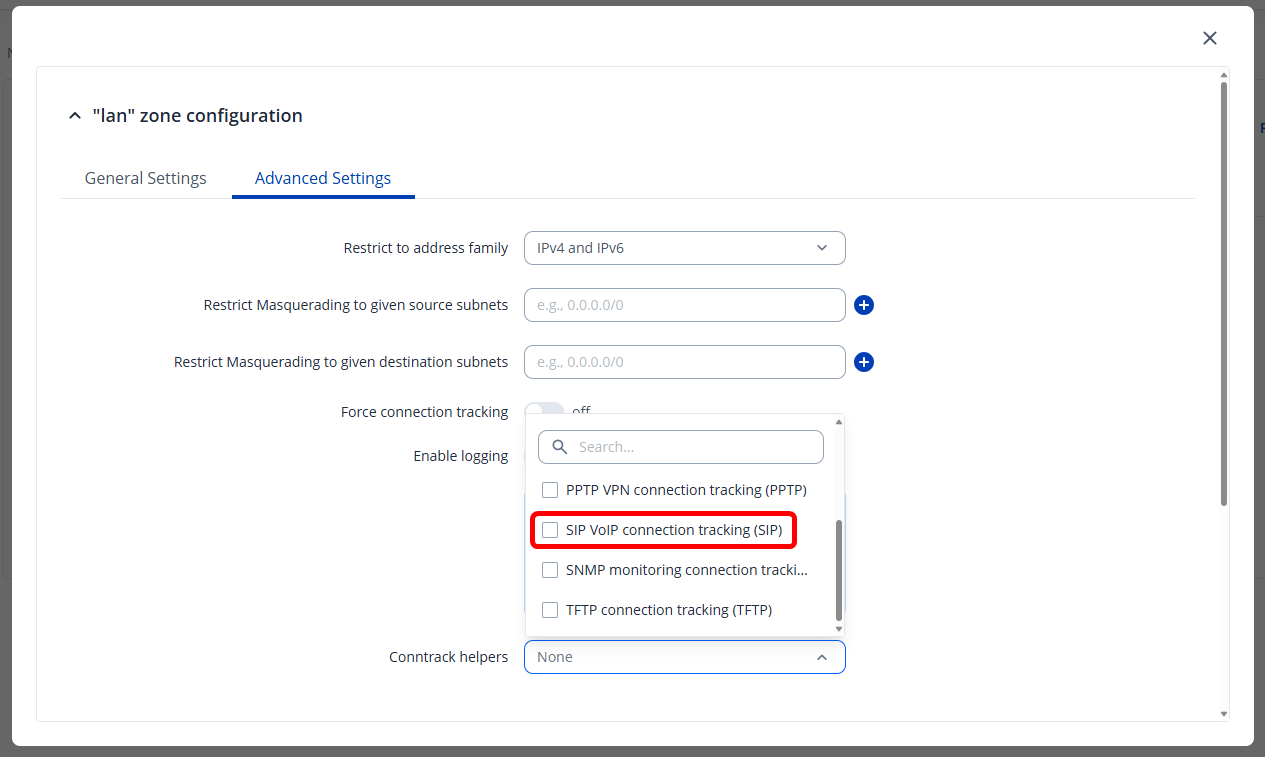

It’s possible that the issue is caused by the SIP connection tracking helper.
You can try disabling it by navigating to Network → Firewall → Settings, disabling the Automatic helper assignment option, then heading over to Network → Firewall → Zones, editing the LAN zone (assuming that’s where the phone is located), and under Advanced settings, enabling all connection trackers EXCEPT the SIP one:

Hello Marija,
Thank you for your reply. I have deactivated the SIP VOIP Helper in all active zones. I will test it in the next few days and share the results.
