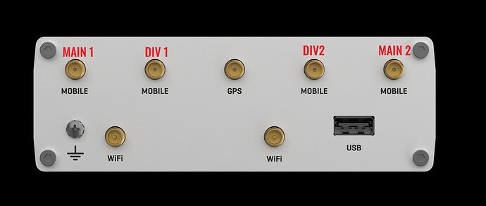

I cant find any info on the mobile ports in the instructions.
My omnidirectional Ponting antenna 4x4 mimo antenna A-XPOL-0001-V2-41 has the following cables marked:
Cell 1 Main
Cell 2 Main
Cell 1 AUX/DIV
Cell 2 AUX/DIV
What cable goes where and does it matter?
BR
Orre
In your case, the antenna should be connected like so:
As the outer two antennas are mainly responsible for low and mid band frequencies, while the inner two are for 4x4 MIMO and n78 5G band. Let me know if the signal improves at all.
Thanks for the info.
I did not see a change in signal strength.
However upload is now about 100Mbps with ping around 14-15, used to be 30-40Mbps and ping 30.
Download is the same at around 300Mbps.
I did “blacklist” B28 but i lost signal and then the router started bugging and “loading”…and went unresponsive. Took a while to get it back to Auto and now it works.
Cheers
Signal strength most likely wouldn’t be affected by switching the antennas, but MIMO might have better conditions for operation.
Glad to hear about the increased speeds!
