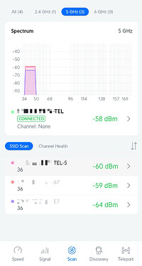

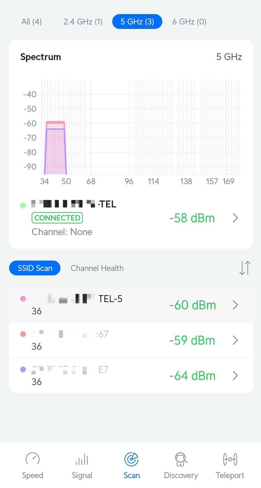

Here is what I have found:

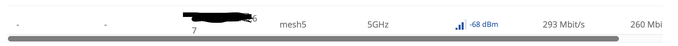

  1. RUTX10 is listed in clients but with no hostname or ip
  2. RUTX10 is located 3 meters below RUTX50 within 1 meter of stairs - see signal strength screen shot.
  3. Wifi scan on RUTX50 shows the two devices on channel 36 and there is hidden SSID on 44 but much lower signal strength at -92. We are rural with no close neighbours.

The RUTX10 node’s IP address should be visible under the RUTX50’s topology map via Status → Network → Topology → Scan LAN results, provided the RUTX10 is configured correctly, meaning DHCP is disabled and it has a static LAN IP address within the same subnet as the gateway.
To clarify why you don’t see a hostname or IP for the RUTX10 under the Status → Wireless page on the RUTX50: this is expected behavior. In a wireless mesh setup, a new virtual wireless interface is created for the mesh link, and the MAC address you’ll see associated with this connection on the gateway side will differ from the RUTX10’s standard wireless MAC address. That’s why it doesn’t appear listed as a typical wireless client in that section.

  • Discovered rutx10 mesh signal strength is close to the -80 (-75 to -79) so switched on 2nd rutx10 running between -50 to -60.
  • mesh still on 5GHz but only running 5G on rutx50 and then as backbone on both rutx10 so devices only connect on 2.4. Don’t know if this makes a difference due to backhaul.
