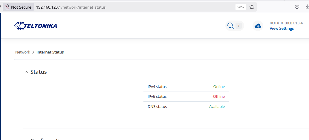

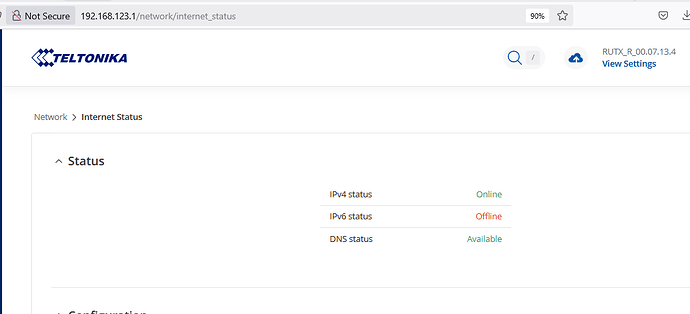

And RUTX50 is working and all other devices as well, but RUTX10 wifi routers can not ‘see internet’ there fore no online updates, no RMS connectivity and no package manager. Here’s RUTX50 Internet status which is ok:

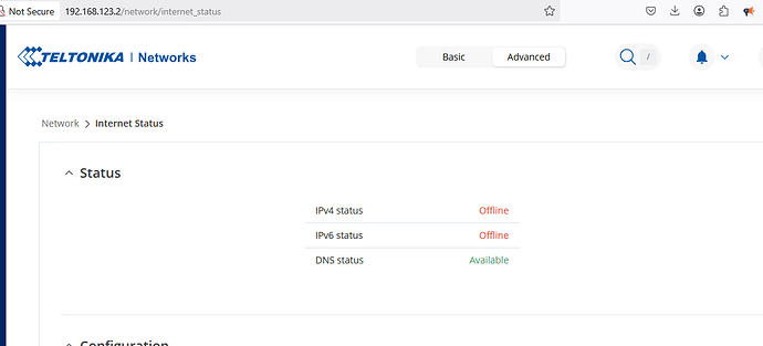

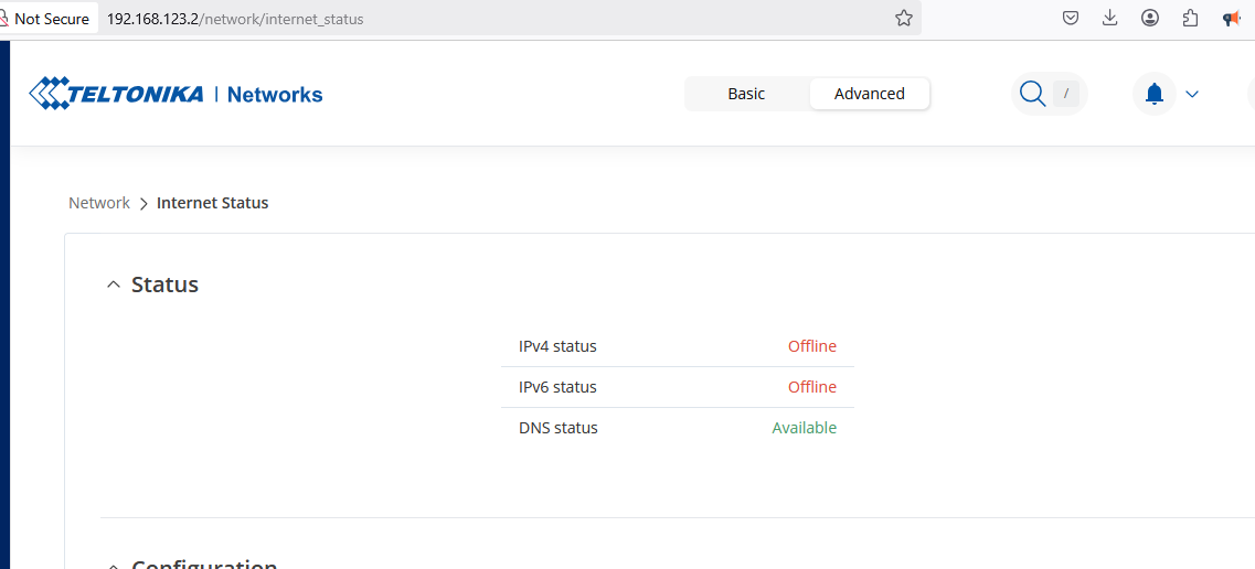

Here one of the RUTX10 internet statuses:

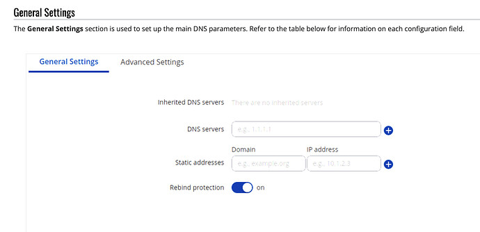

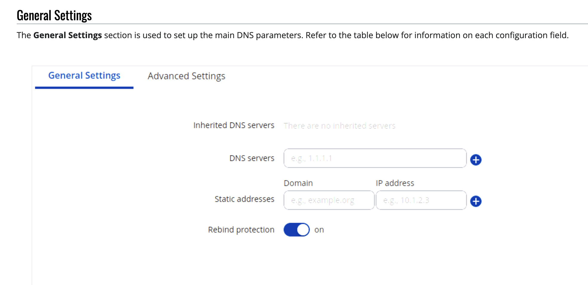

Tryout… Since there is potentially DNS configuration issue, I’m experimenting by switching off a Rebind protection. Based on documentation what says: ‘Discards upstream RFC1918 responses. When enabled, the device will not resolve domain names for internal hosts.’
I do not really understand what it means, but it seems worth trying… Even when documentation says, it is defaulted to be ON.
Results: No change! :frowning:
