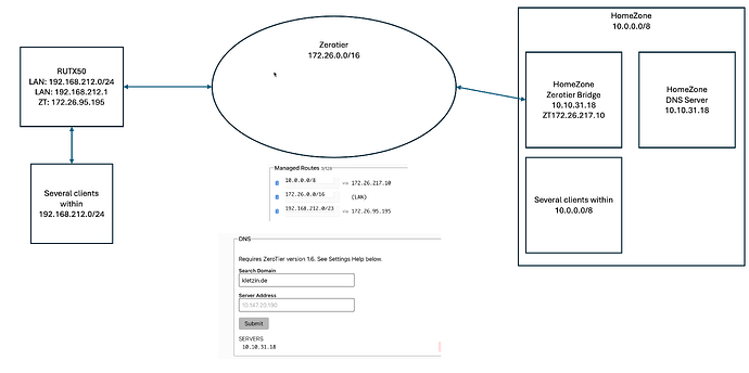

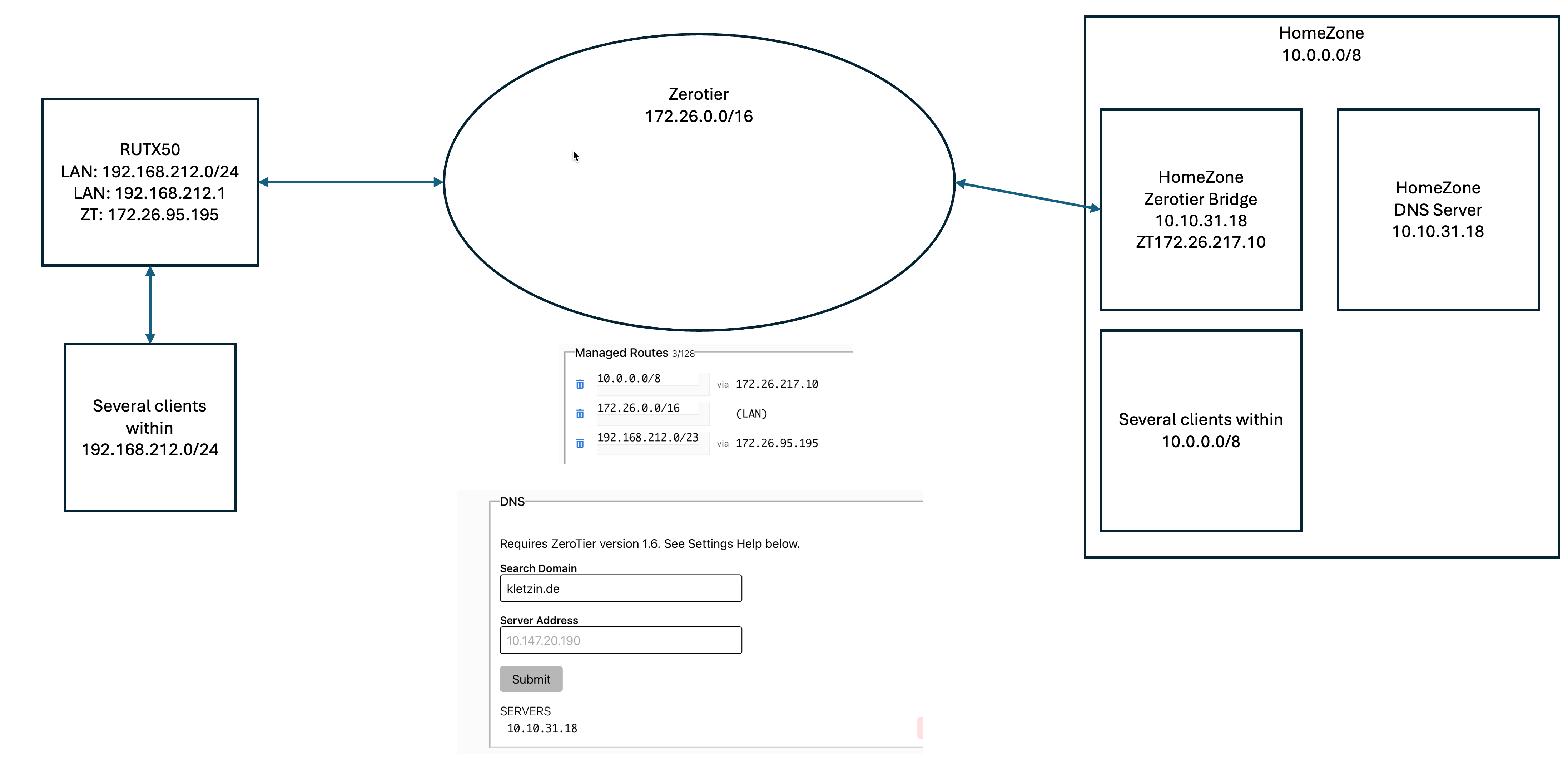

I am using a RUTX50 router in my camper. To connect to my homelab I am using Zerotier. In my homelab I have a Zerotier bridge.
Please see this picture for an network overview:
On IP level the connection is working fine. From the camper I can access any IP within 10.0.0.0/8.
In my homelab I am using the domain kletzin.de with several subdomains for the different services. To access these services with FQDN I would like to use my DNS Server to resolve *.kletzin.de FQDNs by using DNS Server 10.10.31.18. I tried two different methods:

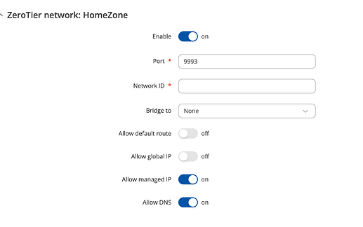

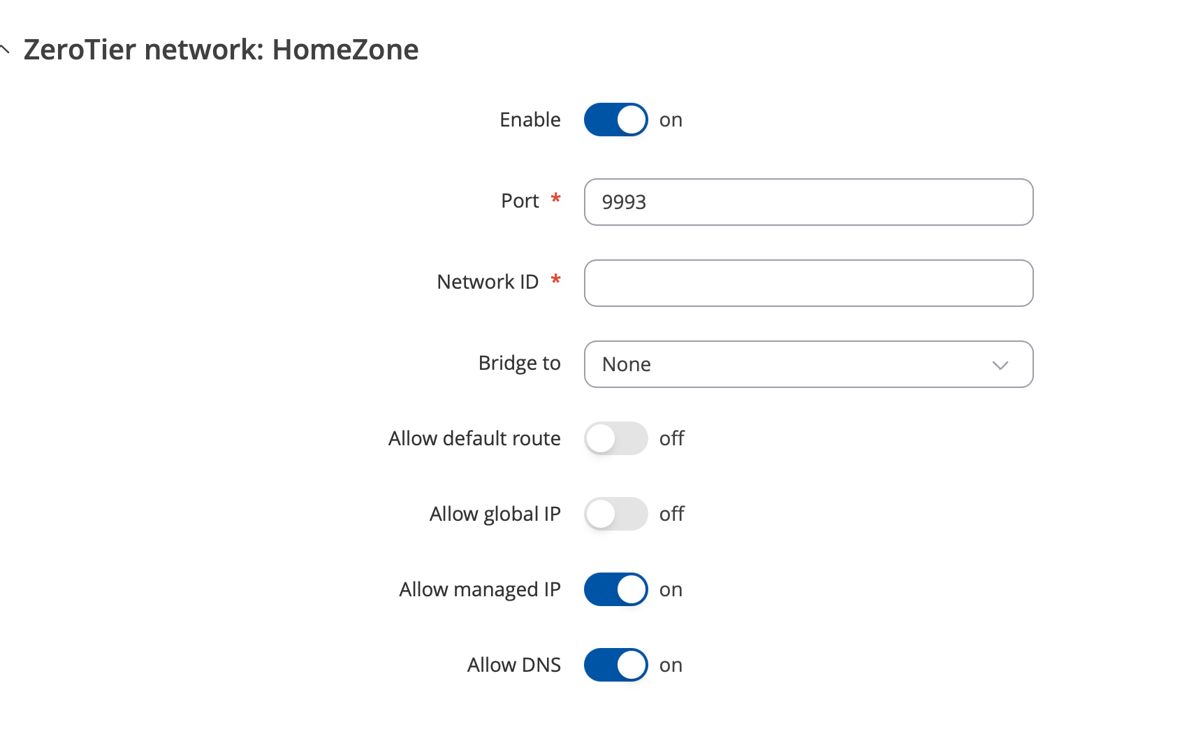

Define DNS service in Zerotier:
When I use my mobile device it recognizes the DNS config within Zerotier, I can resolve against 10.10.31.18. From the RUTX50 it doesn’t work - even if I activate User DNS in Zerotier config.
Any idea why the RUTX50 doesn’t recognize the Zerotier DNS server?

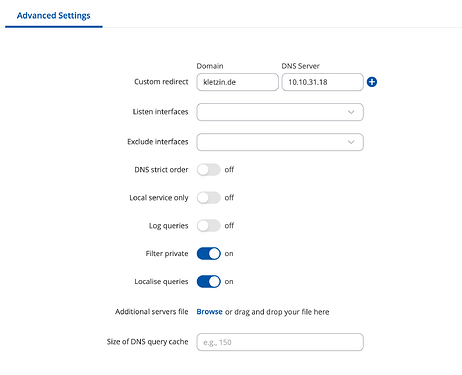

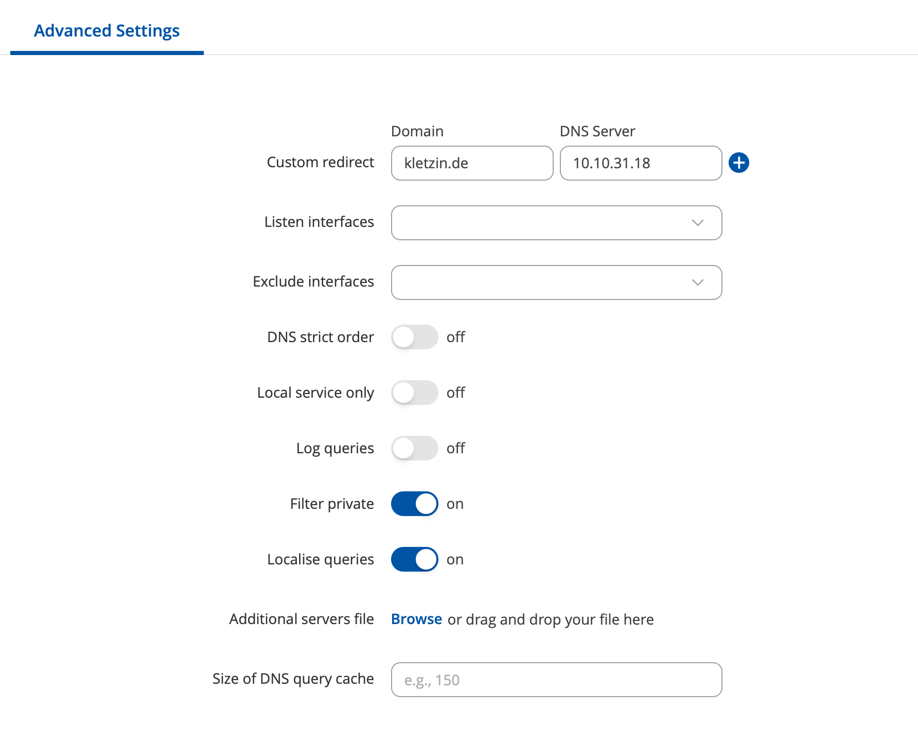

Use DNS forwarding in RUTX50
In the RUTX I have configured the DNS forwarding. That doesn’t work.
Configuration to forward to DNS in my homelab:
Result in CLI:

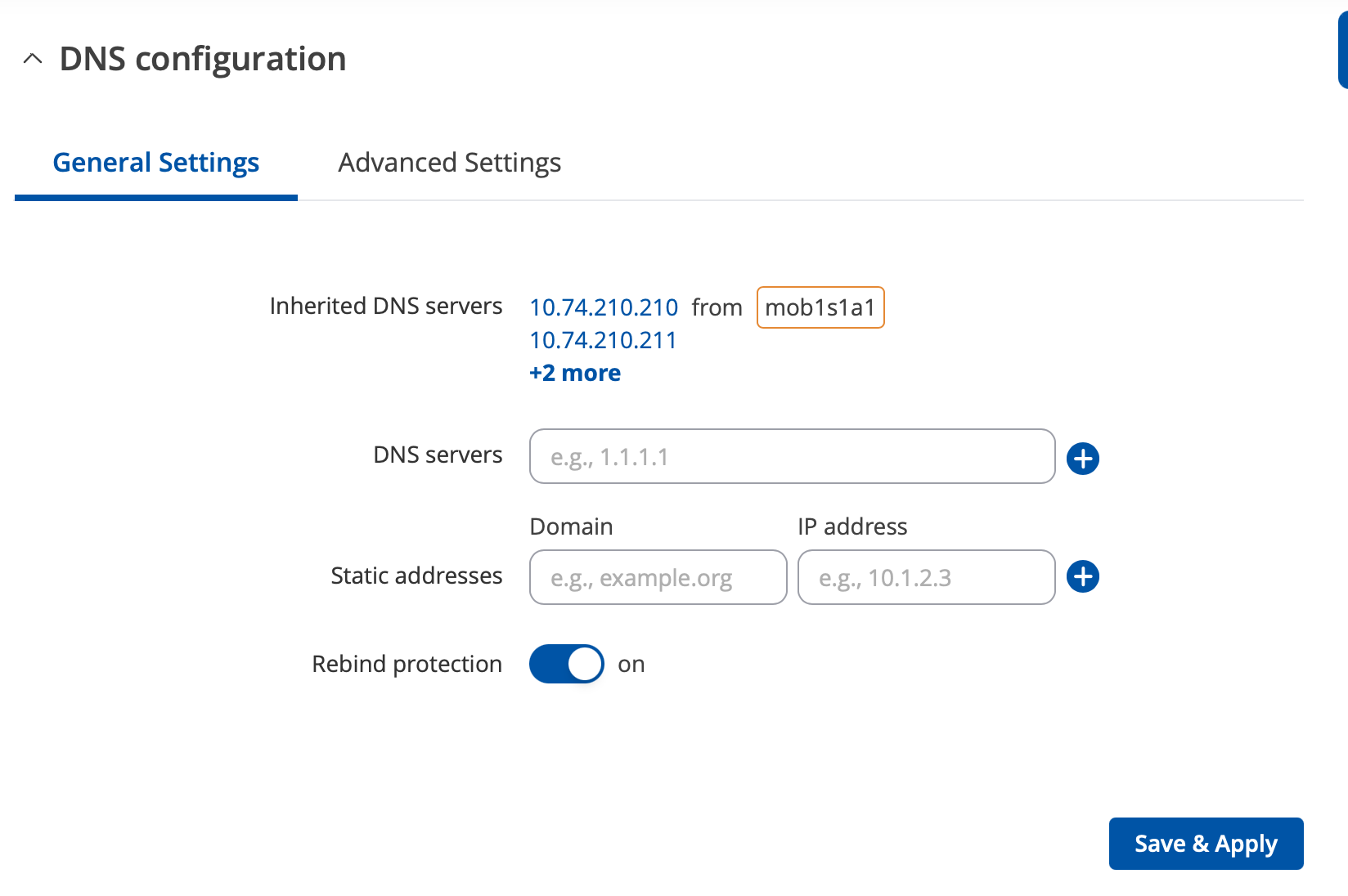

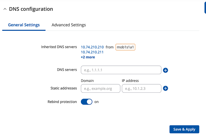

Could you show the Network->DNS->General Settings page ?
Yes, this is the “General Setting” page:
Disable Rebind protection.
Thank you. Issue solved
