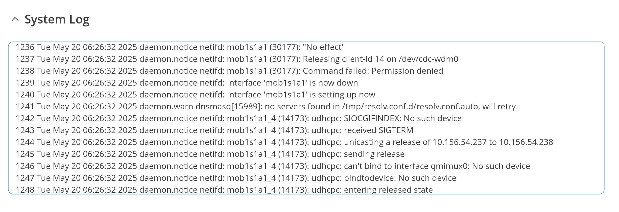

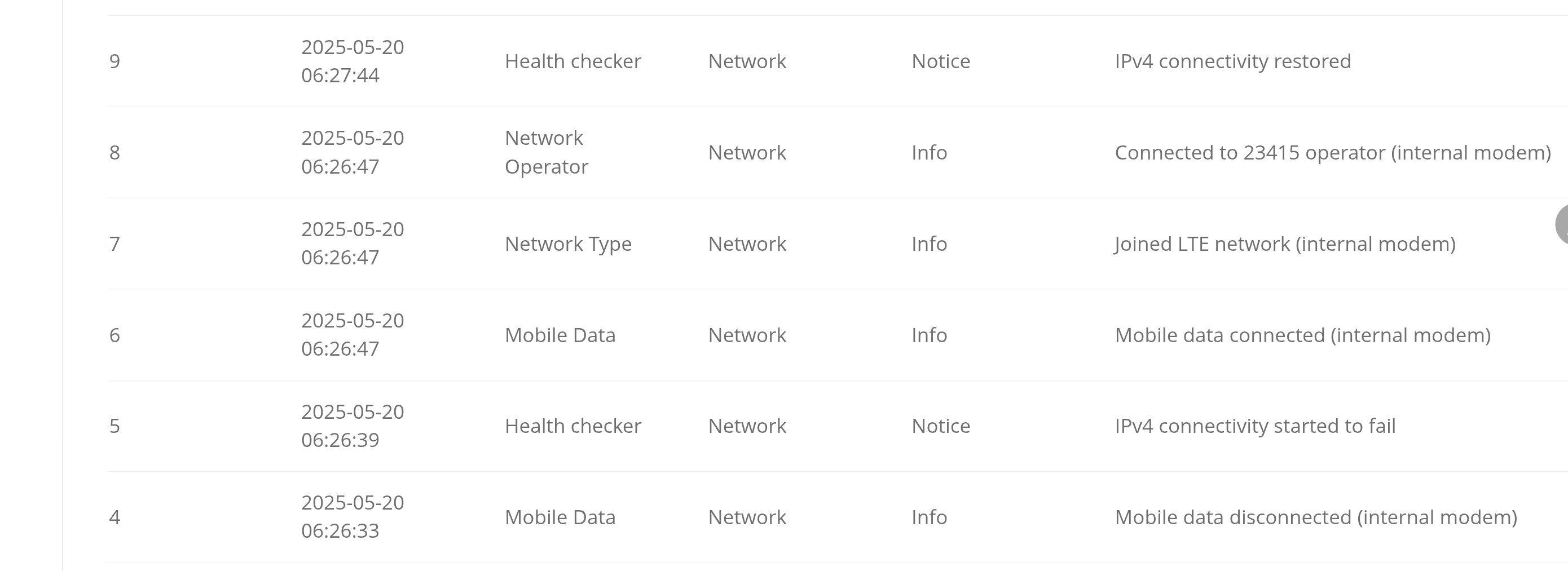

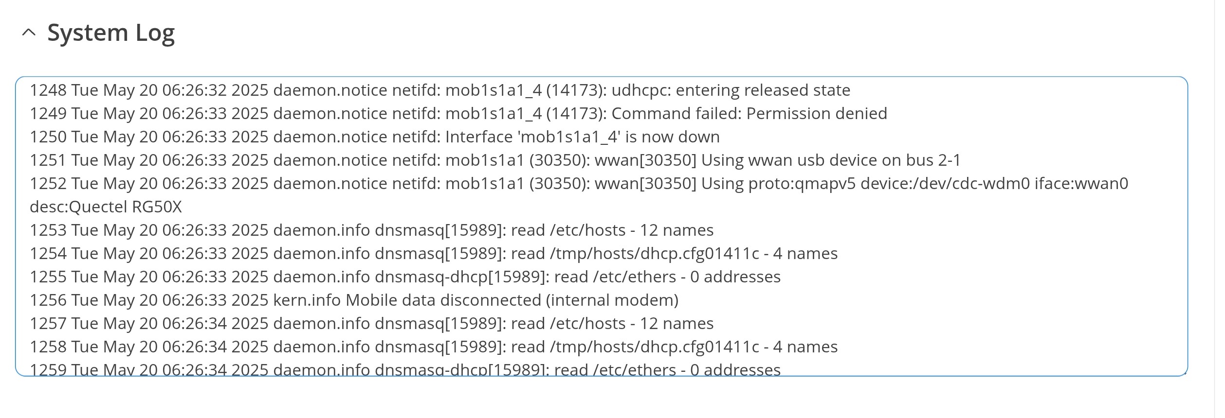

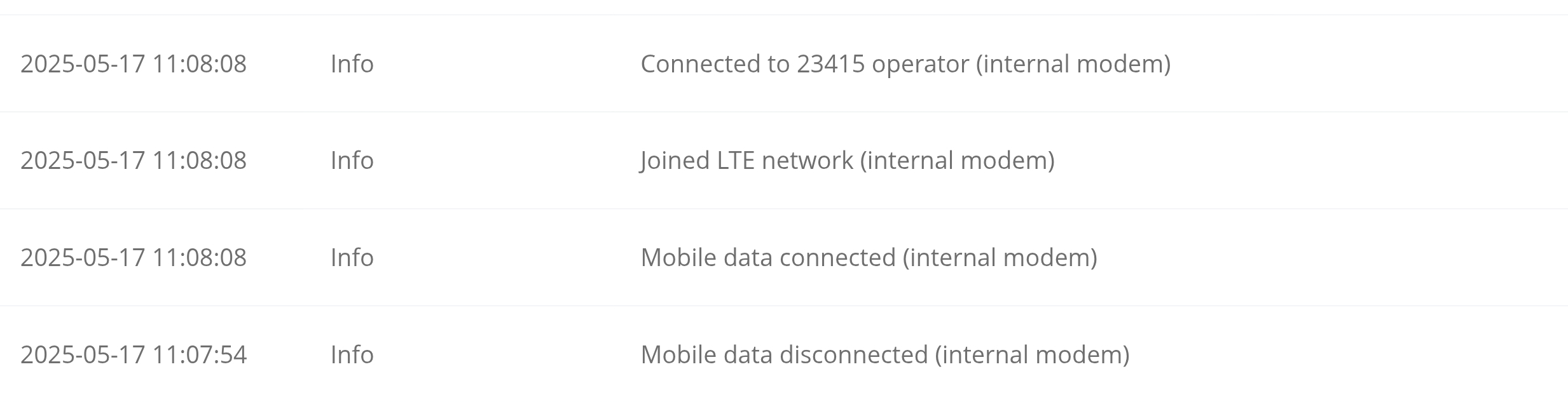

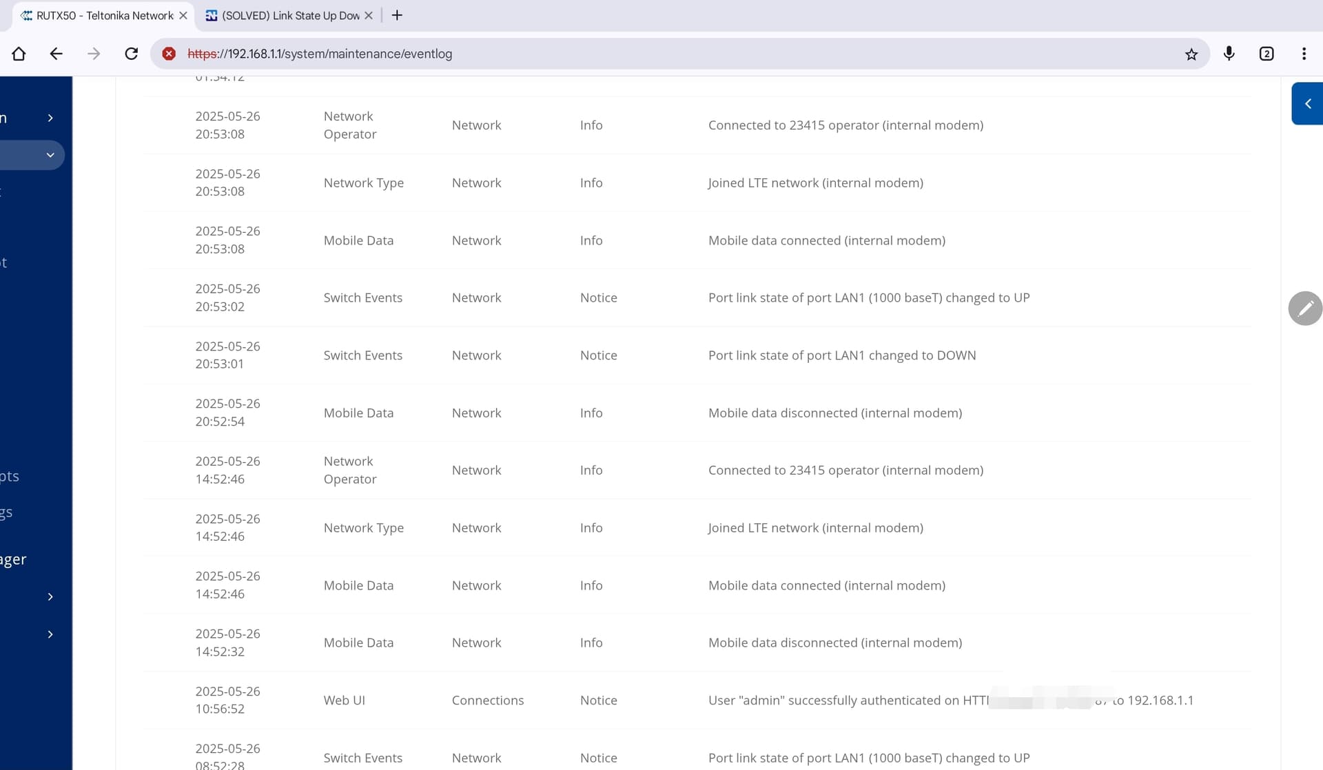

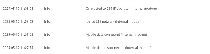

My RUTX50 disconnect every six hours, exactly the same as the screenshots I have attached.
I have looked everywhere for an answer and cannot find one I’m hoping someone can help.
The router has the latest firmware and this has happened from day one.

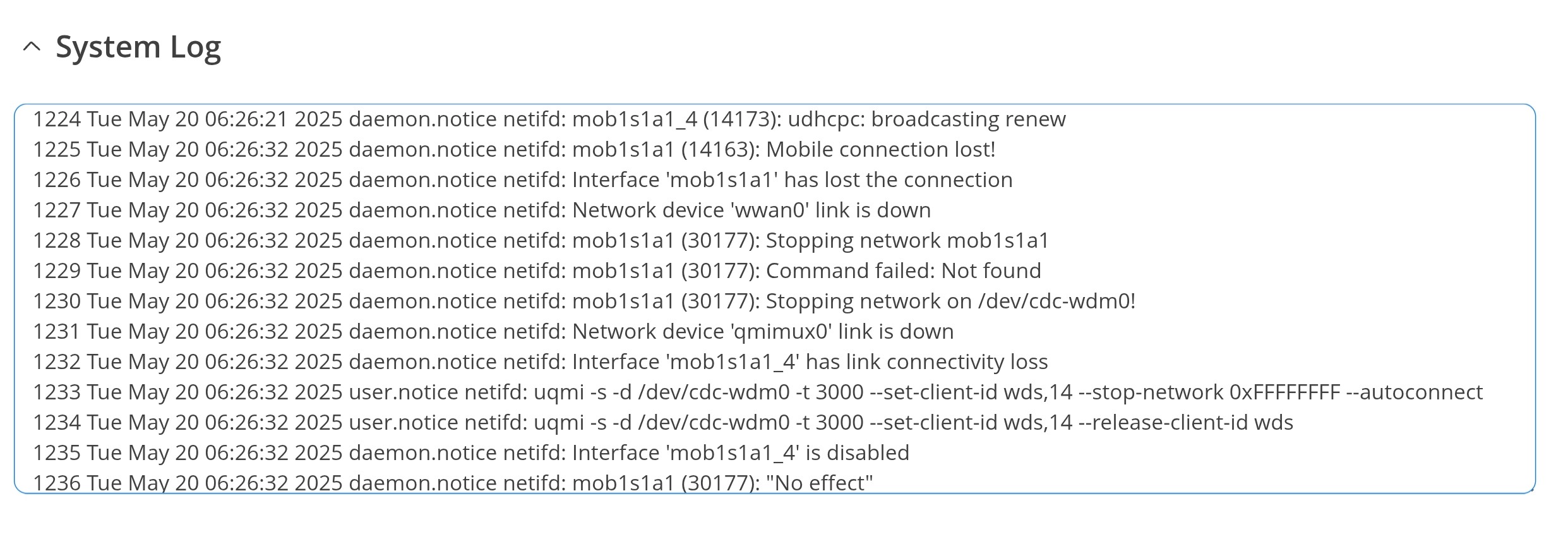

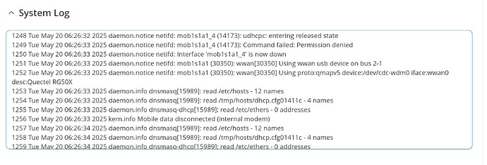

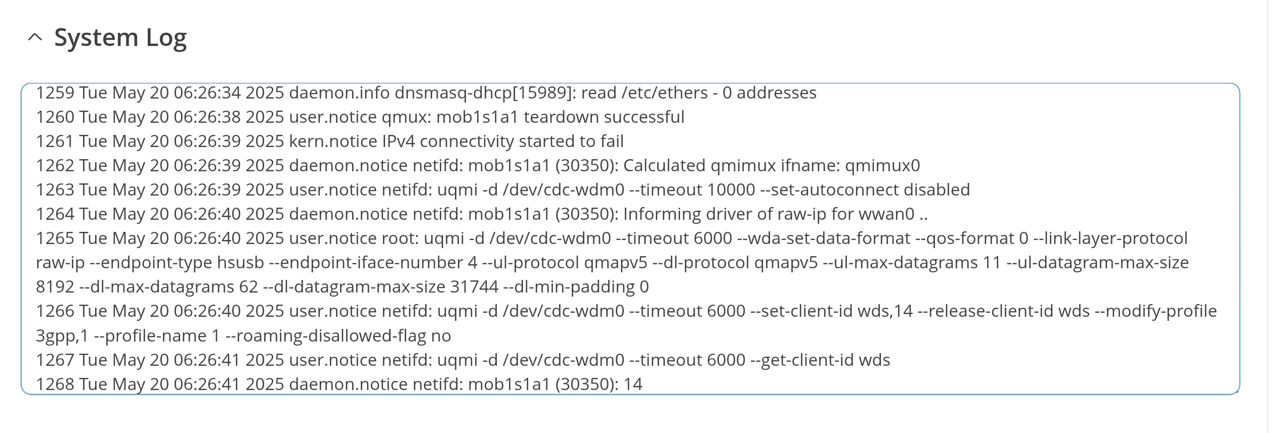

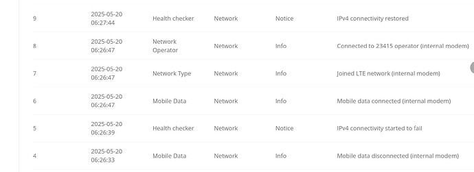

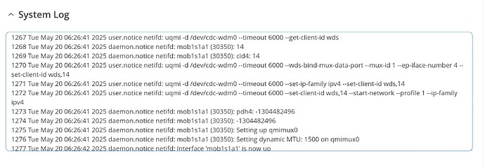

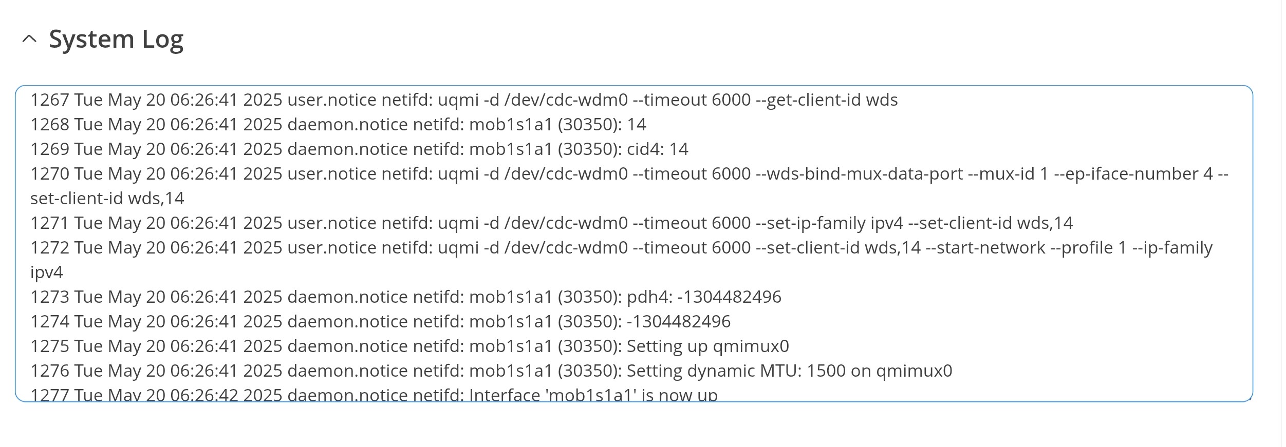

Could you please navigate to System → Maintenance → Troubleshoot, click Show next to System Log, and check for any logs related to mobile disconnections?
If possible, please attach the relevant log entries here (ensuring any sensitive device information is hidden).

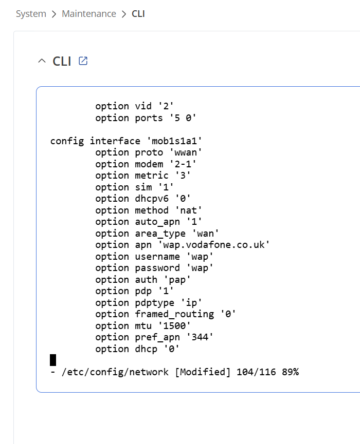

As an alternative, you can directly run these commands in the CLI, which will achieve the same result without needing to manually edit the config file:
uci set network.mob1s1a1.dhcp='0'
uci commit network
/etc/init.d/network restart

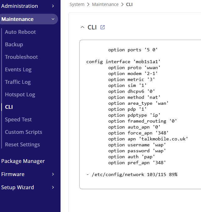

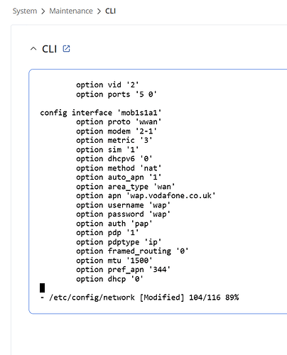

From your screenshot, I can see you’ve entered editing mode using vim. In /etc/config/network, under the config interface 'mob1s1a1' section, you simply need to add this line:
option dhcp '0'
Then save and exit (press Esc and type :wq (hit Enter))
If you’re more comfortable with the commands above, feel free to use those too.
Let me know how it goes.
I can add option dhcp ‘0’ but I can not get it to save. After I reboot it is no longer there, I am going reset the router today and try again.
I think you can probably tell this is completely alien to me but I am learning.
Many thanks
Hi … assuming you are logging into the CLI as ‘User = root’ and ‘Password = [insert the same password you use as admin]’, and to edit the config, you are using the command …
vi /etc/config/network
… then see the following comments.
I guess you’ve found out that pressing ‘i’ lets you edit the file contents, and assuming that you have completed your editing, you have two options:
To Save & Exit, press ‘Esc’ and type ‘:x’ and press ‘Enter’
To Exit Without Saving, press ‘Esc’ and type ‘:q!’ and press ‘Enter’
Probably need to do a reboot or run the command …
… to get the changes to take effect.
