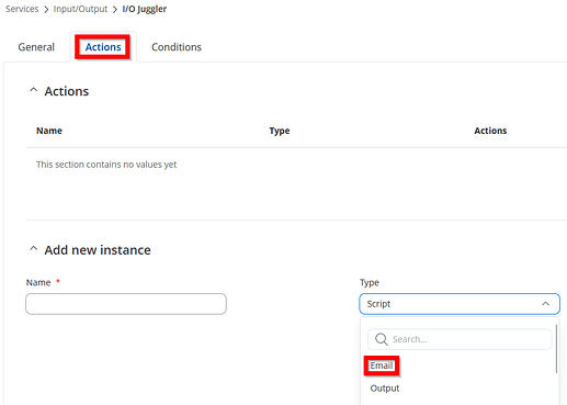

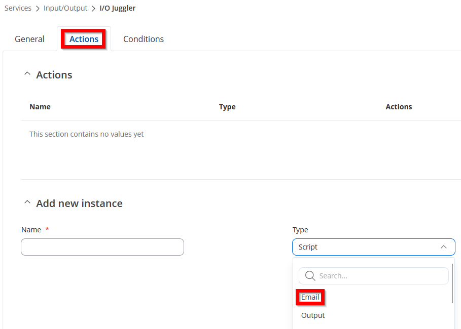

In the I/O Juggler menu, there’s a feature called “Actions” that allows you to send status updates when changes occur. You can send these updates via HTTP, email, SMS, or other methods.More about this you can find here: Input/Output - Teltonika Networks Wiki

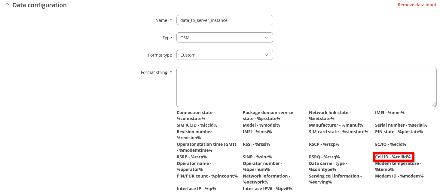

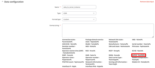

Regarding Cell ID, you can send it using the “Data To Server” functionality. More about this you can find here: Data to server - Teltonika Networks Wiki

I talked with my customer it’s fine to send the cell ID as a status. I will try that over “Data to Server”

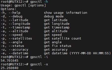

Using only WebUI tools, this wouldn’t be possible as it’s not a typical or intended method for utilizing GPS data. However, you could achieve this by utilizing a bash script to collect data every 10 minutes and then send it.
For this purpose, you could use a simple already implemented command called gpsctl. More information on what it does can be seen below:
